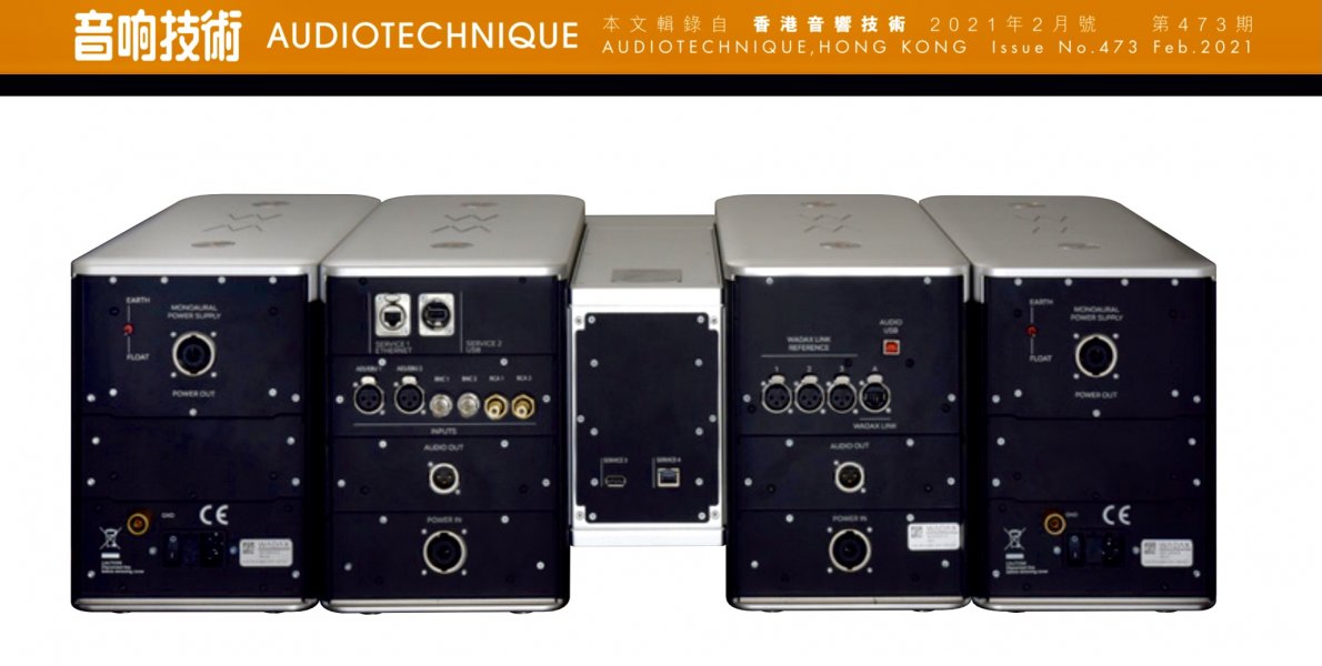

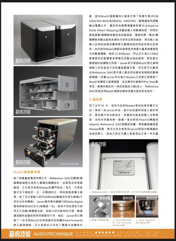

Some of the photos showing its internal architecture are interesting :
