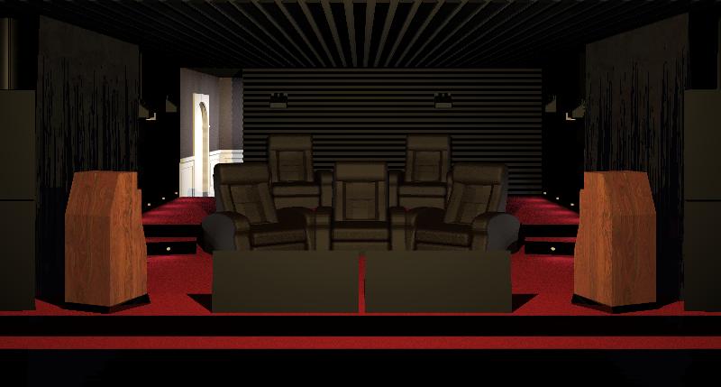

Now, this is still what was planned before I noticed the dampening towards the exterior was insufficient, so from here on I'm planning to use this model to try different solutions and what that will do to the interior. Had that not happened, I would probably have been able to show the finished job next fall, now I don't know when, but I wasn't planning a grand opening until 2017 anyway, so... :cool:
Here's an impossible shot from behind given the back wall, but for showing off the (non-rebuild) Vision for 2017:
Probably aim for black drapes, but they don't trace as nicely (or at least I have not yet found the right settings for black velvet)...
Thanks! :)
Here's the latest update, managed to conjure up better textures for both drapes and chairs and gone on to model the back room too:

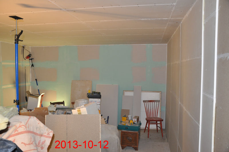

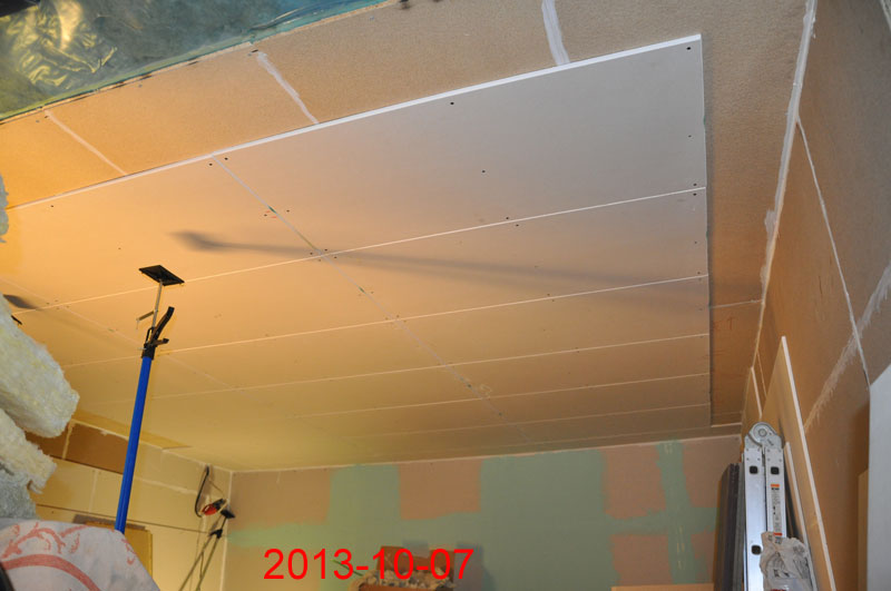

Spring is here, so tearing the old walls have been begun... but it'll probably be a year or more until I get back to a point of looking at finishing touches like wall/ceiling diffusion, carpet and black paint...
Everything proceeding slowly but according to plan, frontmost 60% being reconstructed this year and that part is starting to look like a room again, but 14" narrower...

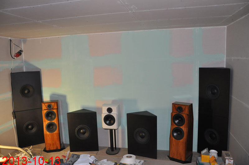

Test played the fronts with subs last night at higher volumes than I'd really want to listen to the music and the results were better than I had dared to hope for. It does still leak in the part I haven't handled, but it seems quite a bit less than how it leaked in the front part. Main issue is the door to the exterior, so I will add some drywall to the inside of it and build a seal. But as I will be building new inner walls there next year, I'm definitely considering adding a soundproofed inner door as well.
On another note... if sounded spectacularly good even in such a reverberant space as the naked walls pose. And it will only get better! :p
The door is the killer as far as sound leak. My theater is fully insulated but I have yet to put the door seal on and boy so much leaks through the bottom of the door. Plan to put a pop down seal in the door but just been too lazy to do it :).
Have put one layer drywall on it now, not caulked yet. I agree, that made it much more audible that the sound leak was concentrated around the edges. Door is vibrating more than the surroundings too, so adding more weight will be a good thing. And then I have to seal it better, question is if I can really do that before that wall comes down next spring, though.

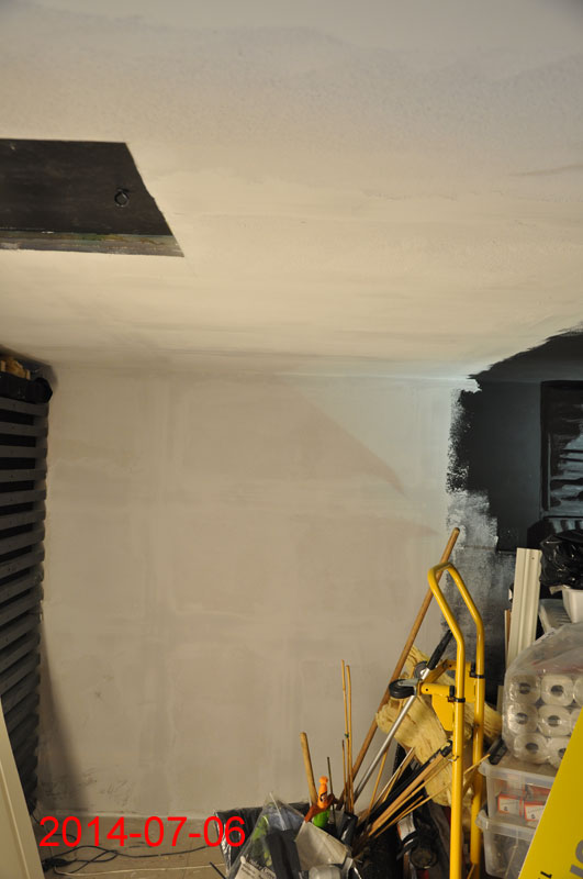

Currently putting my painters' hat on, doing taping and mudding now.
Not that long until I can start painting this half of the room black too. :)

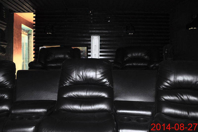

System back up and running. Still more things to move out, fiddle with and upgrade, of course.
Here's a reverse shot from today. 28mm lens not quite up to the task of covering the whole width,
And from way back too:
Carpet is red too, btw.

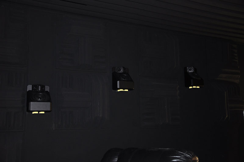

Here's the three speakers that play the right surround channel (SR) on their soft feet (possibly not done with these speakers before):
