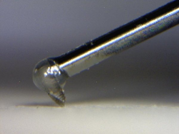

Got some great advice earlier today and was able to remove the plastic ring on the Dino-Lite so I could increase the magnification. To me it only made this more complicated as this stylus is quite complex. I am agreeing with Mike.... I'll probably rely on my ears to get this dialed in.....
For your enjoyment I've attached the best pic taken this evening....... would like to get it sharper but this is as good as I can get it.....

Nice photo!
Eddie: How did you remove the ring?
Bottom line, the microscope, oscilloscope, Fosgate, AT, Feickert and whatever equipment one uses to align a cartridge is very important in getting that first approximation! Then one can fine tune it. If the basic parameters are off, then anything else one does is hopeless :( Also, as I'm getting older, even with glasses, I'm not that confident in what I'm seeing :)

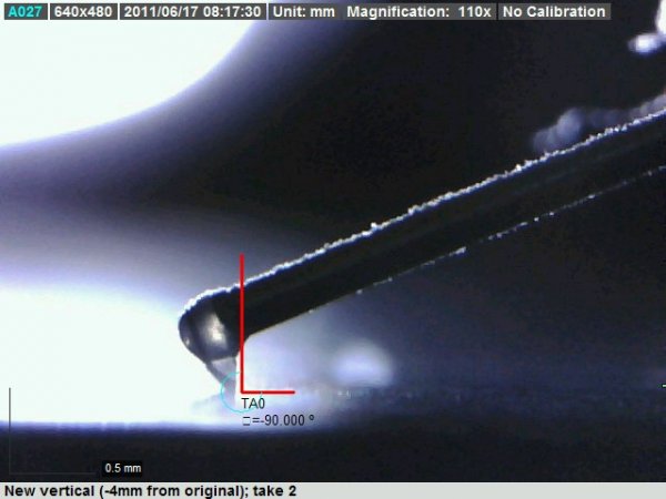

With the ring removed so that the lens can get closer (which also removes the LEDs, therefore, backlighting was employed) I get 110x optical magnification. The first picture is the old vertical as set by the human eye with the aid of 10x loupe; the second is a new vertical with the arm lower by 4mm than before.
Old:
New:

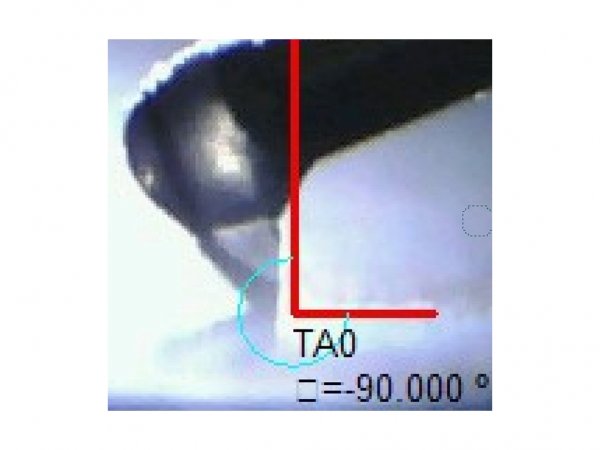

Zoomed in "new vertical" at the tip:

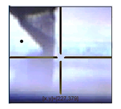

Although earlier I believed the "new" vertical is the correct one, I now have doubts... So this is now a game of pick-your-preferred-vertical :)
I am not sure if the 'scope was positioned precisely parallel to the record...
Reactions: Doak
GIMP to the rescue - 400% magnification indicates that the original, eye-set, vertical appears to be dead on; the "new" one is clearly slightly off:
Old:
New:

I should also point out that my initial attempt at getting the stylus vertical was actually based primarily on attempting to get the arm parallel to the record using the recommended VTF of 2.3g; after achieving this, it apparently turned out the stylus was indeed perfectly vertical. Therefore, I am tempted to conclude that this is an accurately built cartridge that conforms to the manufacturer specs.
Perhaps I took a long shot in assuming the cartridge is well built, and tried to approach it from that perspective - start with the recommended parameters and see where it takes me. But it appears the results are as expected. Sure things will change over time and will readjust accordingly, but it really looks to me this cartridge is very competently built.
