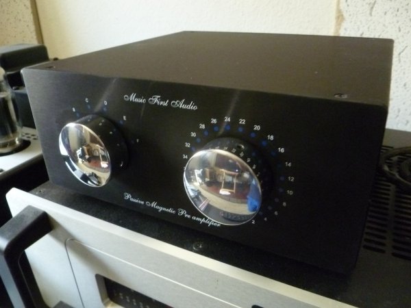

A non issue for TVC based solutions.
I have tried Transformer and Resistor loaded volume controls, my favorite are resistor loaded shunt type: there are a few different types, the shunt type uses less resitors on the signal path. Check out the Goldpoint web page they had a nice description of the different volume controls they handle, maybe it is still there!

Even if someone likes active preamps better, with gain or no gain: the volume control Always makes a difference!
Volume control basically is the transparancy. Screw it up and you forget about it, unless you listen with the volume at full 100% of time.

The point was that the contact in a switch with diferent positions is part of the problem within a volume control: it could be bypassed in such a way with its consecutive problems. It is interesting to try if only to see what we are missing. Like making the Ravel Bolero test.
Both active and passive use volume controls.:)

Interesting point. I have though about it very often, as I have owned several preamplifiers having high quality switched attenuators. Some have up to 32 positions and most of the time I used only one fifth of them. If I was sure about which I would use I could have it manufactured using high quality resistors, such as the ultra expensive Caddock's top of the range, in these more often used positions and lower cost ones in others.
