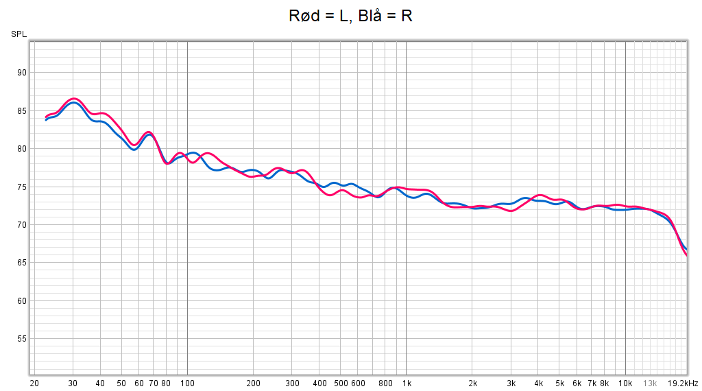

Looks awful but sounds good to me. The bass node is due to room size and there’s no way I can trap 28hz.easily.
You are lucky that your main peak is so low in frequency, most music won't go this low, so it won't have a lot of practical consequence. You are right it would be difficult to treat with traps or absorbtion, but EQ would handle it easily, but I assume you don't have that capability in your audio chain.
If you measure at the corners of your room and they also have 28Hz peaks, you could buy PSI AAVA C20 or C214 and place them at those corners to reduce the peaks by a bit but more importantly reduce the resonance at 28Hz by quite a bit more. It is likely the resonance is blurring all frequencies slightly in music that hits that note. You probably don’t even need to use REW to do a full measurement of the corners. Because you’re just trying to see whether the 28Hz is mostly coming from the corners, you can play pink noise and just have an iPhone app running AudioTools to see what the frequency response looks like at the corners.
Another option would be to replace the GIK corner traps with the Vicoustic Mega Bass Trap XXL. But these traps are really really huge. Hence PSI AAVA is more practical?

That resonance at 28Hz is inconsequential in the real world. There is very little music which routinely has frequencies that low.
All interesting comments and something to think about, thank you.
BTW, if I cut off the Duo subs at 30hz rather than 20hz the music loses its natural extension, slam and sounds ‘off’.

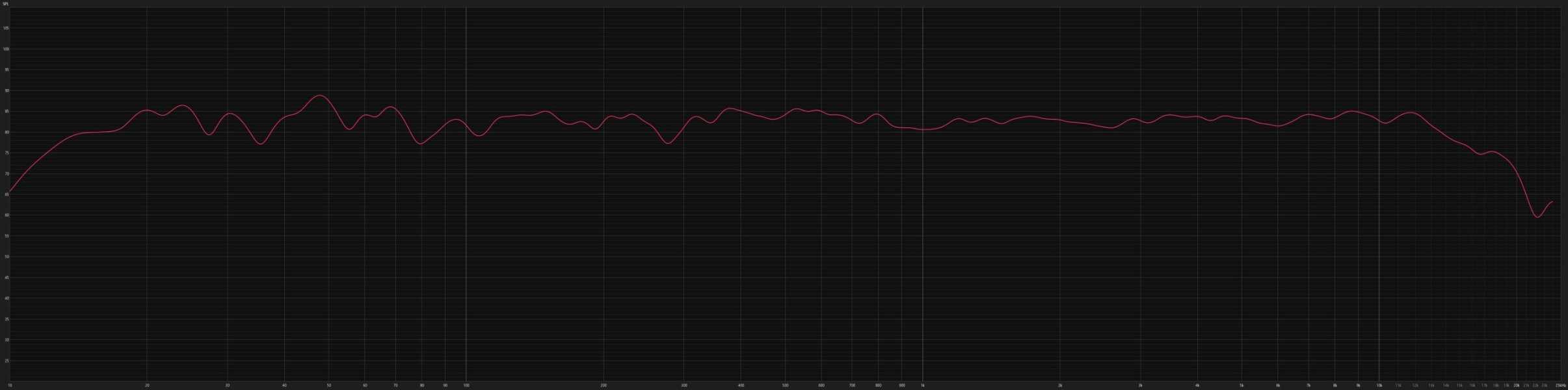

Listening position (12') with 1/6th octave smoothing. Each major vertical division is 5dB.
Step response taken from the same position - a single impulse. This is the major benefit of time-aligned drivers, and improves imaging.
Reactions: ecwl
It will still have audible consequences as there's more information around 30Hz than one might think. Plus it's not just a peak, it will linger (RT60). I have a similar room mode, subs was the best way to manage it IME.
Sure, but it would be worse higher up. :)
Reactions: sbo6
Acknowledged but it would be better if it was flattened out altogether. ;-)
It's like saying, I'd rather have 2 flat tires than 3, but either way, you're stuck. ;-)
I wouldn't say that's a great analogy.
That being said, I of course agree, and recommend having a system where everything can be flattened out, aka access to EQ in the entire bass area, typically high passing the mains. Alas, many is not interested in that approach, and would rather keep a pure system with full range mains and possibly a sub lurking in the last 0.5-1 octave at the very bottom.

Draw a line from 100 Hz to 10 kHz. The shallow valley centered at 2kHz is very much intended. Closed box below 45 Hz, dipole above.
