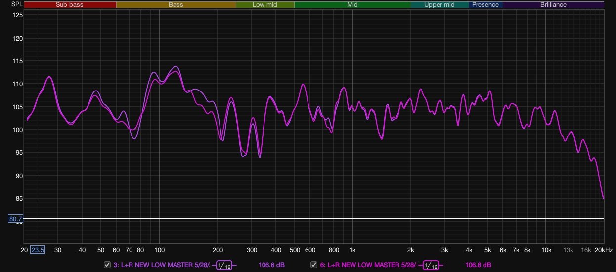

FWIW, this is my latest listening position response plot.

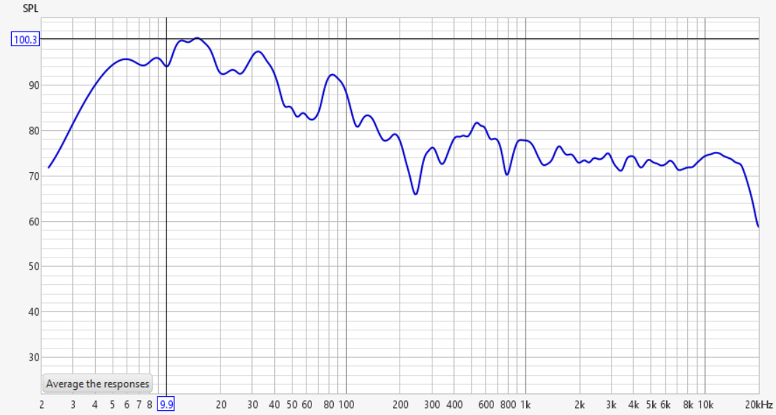

Don’t know what I made wrong, my bad! This is the last measurement from listening position.
With and without a bass trap on the right corner.
The room is 12x18x8 - here below a recent pic
