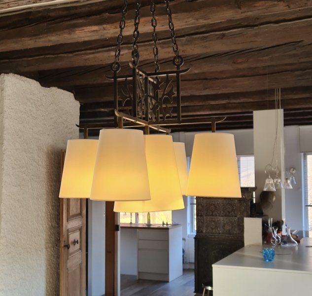

My wife wanted to change our lamp shades. We got the new ones today. I took two pictures. First one shows the CE certificate. Where the bulb sits. The second one the lamp.

Gunnar, you have a stylish lamp !
