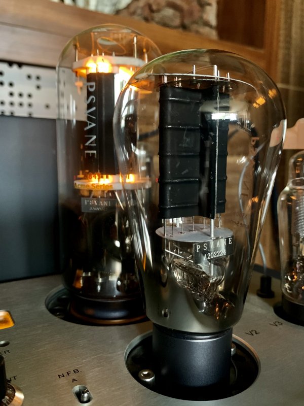

I got the acme 300b as well. I took out psvane we300b replica plus tubes. Now acme 845 has his sister to play along.
I bought these tubes from Grant Fidelity. The North American authorized distributor. They redplated. Both. I took my amps to a tech. He said my amps are working perfect. The bias is right at 97 watts. The 845 tube should dissipate 100 watts if built correct. I wrote Grant Fidelity and was given a baloney story in my mind, and 2 other tech minds that a tube should not be run at its full potential. Whatever. Be careful.
After a bunch of research I found you have to have your amps re-biased to 85 watts of plate dissipation to have these tubes funtion and not burn up. They don't appear to be a true 845 tube. At least they can not dissipate 97 watts, let alone 100 per spec.
