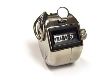

Buy a quality mechanical 'click' counter- lo tech, no digital, no batteries, no hard to read displays, you can get one from Amazon for 15 bucks. The one I bought is chromed metal of some sort and has a little heft, so it doesn't feel like it will break immediately. I have mine nestled into an old rubber 'footer' that keeps it upright, so it sits next to the machine, I don't have to hold it in my hand to use. Everytime i clean, i click. It's like counting heads at the turnstile or something.
The exact one I bought is out of stock but basically looks like this. See above. They also make ones that are mounted in a base, if you don't have an old rubber footer laying around. (What kind of a-phile would you be if you didn't, though?) :)
I use clickers to keep cart playback count. Every click (each side) represents 20 minutes on average. I feel that is a realistic count for cart hours. 20 x # of clicks divided by 60.
I apply a round pre-printed label to the new inner sleeve that I use for each freshly cleaned LP. I can keep count of how many LPs have been cleaned by the empty label sheets.
