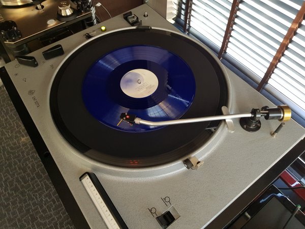

It is up and running now. I installed the rewired Ortofon 297 back to the EMT yesterday. The new copper wire is from Cardas. I also bypass all the original nonsense wire routing fron tonearm directly to RCA input of my phono. It is nonsense for me because the original wire routing is for 927 that comes with an original phono box, but my EMT didnt come with the phono. Picture below shows how the wire run before the bypass. Too fuzzy with many connecting points.
Before the tonearm was rewired I had the Anna on. I didnt like what I was hearing. To be honest, the sound was a few steps below both my Techdas and Kronos setups. Now instead I put Atlas SL on the EMT J-headshell. The four legs of headshell where cartridge leads suppose to attach to were too long I had to trim them short and soldered the leads to them, otherwise I couldnt mount the Atlas on this headshell. Ddk told me to keep the distance from arm end to the tip of stylus around 31 mm. Thats what I did. With the EMT J-headshell and Atlas SL, the counterweight of the Ortofon was not enough. I had to diy additional counterweight with a brass ring. It looks stupid but stupid seems to work just fine.
The sound? Wayyyy better than when I had Anna on the arm without rewiring and a bypass.
I have only been listening for 5-6 hours. With the rewired Ortofon 297, the sound of Atlas is a lot less "show off" almost like it's been tamed down on the analytical part, which now sound very pleasing. The dynamic is still A+. I never heard the Atlas with such good vocal like this. It even sounds warm. The tonal balance is not like I used to hearing. Very unlike Atlas SL when on SAT arm. Am I hearing the table or arm/cart combo, I havent figure it out yet. I will write more to try to describe the sound I get from this EMT when I listen to it long enough to have confidence in saying. Right now I am just enjoying the 927 very much. It is now at least on the same level as my other two tts, but I still have more things in my sleeve to optimize the 927 which will further better its sq.

Nice. What happens when you use the Arche headshell on your atlas instead of the EMT?
You cant use the Arche on this Ortofon arm. The Arche is too long to mount any cart for a proper setup with this arm. 31 mm from the edge of the arm to the stylus tip is critical. The J-headshell is very short.
Wait another three months when I get my custom Axiom 14" for the 927, I will let you know.
Btw, You see in the pic I am not using any record weight. Maybe you want to send me the expensive Dalby of yours to try Kedar. :p
