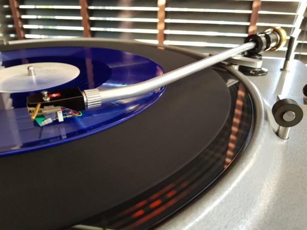

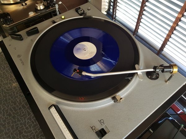

Maybe my writing is a bit confusing. I meant the Anna sounded dull, not analytical, when it was on Ortofon arm before the rewired. The Atlas SL on SAT arm sounds "show off" with a lot of details. But with Atlas SL now on a rewired Ortofon, it sounds less detailed and has warmer tonal balance but still very alive. The images are somehow more solid than what I hear from both Kronos and Techdas. The 927/Ortofon/Atlas is very musical. I listened to John Fahey and felt like he was really going at it on his guitar.
One thing for sure the wiring that originally came with my tt and tonearm took the life out of music.
I have one problem that I didnt say. The antiskate on this arm is difficult to adjust. I had a problem on the first song of a record. When I droped the needle it would skid into the first few milimeter of the song and then track normally. I then adjusted the antiskate to the point it no longer skid into first song but when I lift the arm I could see the cart swing to the right a little. This kind of bugs me.

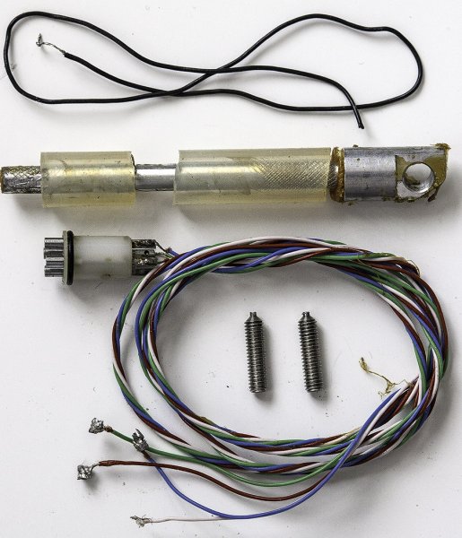

I used them with the SPUa of course. With much ado and finally sweeping diagnosis I found to correct the deficiencies and replaced the items pictured --in both arms! allowed a whole new sonic vista to be unlocked
and the Arms performed to my complete satisfaction.
The spring VTF force was a mess
the side mount pins on one arm was badly worn--as pictured.
I presume you have checked all and sundry on these aspects mentioned--if not may pay to at some stage-.

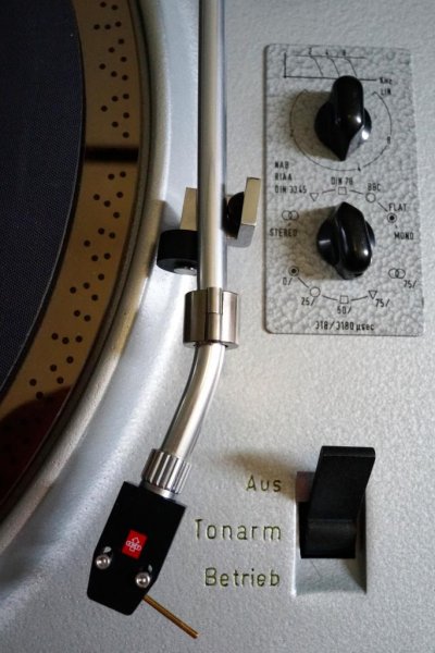

I just learnt about how to adjust the anti skate of 297 a few days ago. The adjustment is actually underneath the plinth of EMT. I also tried to adjust the VTA to get a sharper bite of strings and maybe get a bit more detail sound, but turned out not getting much of what I want and also lost rhythmic drive and solidity that seems to be a signature of this tt. I think I am too familiar with a very high def, detail sound from both SAT and Axiom. The vintage Orthofon just can’t rethrieve info from the groove as good as these modern arms. Can’t wait to try a modern arm on the 927.

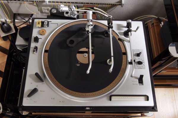

Tango, congrats on the soldering of the Atlas into the EMT shell. I know what it means if you look at my A90/EMT approach.
The Ortofon 297 is an excellent tonearm especially when you are using EMT carts. This wonderful table deserves a vintage design (why not with new inner cabelling which I did not go for so far). In case you are going for a heavier cart/headshell you may use an additional weight or a heavier counter weight as shown with the Neumann/RMG 309 combination.
A Fidelity Research FR-7f cart with diamond connection also needs more weight. You can mount a different counter weight (RMG 309) at the rear of the RMA 297 or you are just using this little device.
The other arm pictured is the 1st SME (the real 1st series one)!
