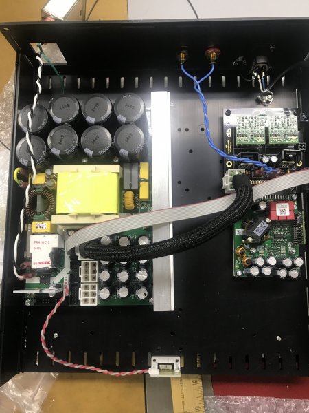

Below is a pic of the Stock VTV amp using the 3000 watt power supply, the Purifi module and the VTV front end board using Sparko labs regulators and has the Pro Sparko labs discrete op amps installed. A pair of these is $2228 delivered. This pic taken on a bench at VTV. I will have this amp.....and its brother....next week.......then the fun starts with all out mods. This is a world's first.....mono amps using a 3000 watt power supply with the Purifi modules.
I just now found out that if you click on the picture and then double click again you get a mucho bigger pic that you can move around.....way cool this internet thang!
Hello everybody,
I would like to chime in and share some important facts regarding our PNC1200 amplifiers.
1. Using the Hypex SMPS3K/A700-A400 (3800 watt) power supplies with half bridge class d amplifier modules like the NC500, NC1200, Purifi 1ET400A is not the best choice. This is especially important when using the Hypex SMPS3K power supply in a mono block configuration. The Hypex SMPS3K power supplies do not feature the 2-quadrantoperation as most other Hypex SMPS power supplies do. Therefore, they are unable to handle large reverse currents generated by half-bridge amplifiers operated at low frequencies. For this reason, it is not advisable to use the Hypex SMPS3K to power half bridge amplifiers like the NC500, NC1200 and Purifi 1ET400A modules when used in the frequency range below 100Hz. Hypex does not recommend using this power supply for half bridge class d amplifier modules either. This is the main reason why we have chosen to use the Hypex SMPS1200 power supply which is designed for the NC1200 module and other half bridge class d modules.
2. The NC1200 modules in our PNC1200 premium amplifiers are not stock modules. The modules are modified. The stock NC1200 class d modules have a THD+N reading of 0.001% and the modules in our PNC1200 amplifiers have a THD+N reading of 0.0005%. We achieved far lower harmonic distortion with our implementation and mods.
3. We use pure occ copper and pure silver wiring and pure silver binding posts so no mods are needed here. Trust me;)
4. Our custom linear power supplies in our PNC1200 amplifiers are also powering the modulator stage of the NC1200 module as well. They are not powering just the input stage like mentioned above. Clean power for the input stage and modulator stage is very crucial and it is very audible.

Have you listened to the 3000 watt supply on a single Purifi amp module (mono amps)? If so, how did it sound different from the 1200 watter? This is what really matters.....the sound. Since you believe what Hypex states......you probably did not go out of your way to buy the lower voltage power versions of the 3k supply to test on a Purifi. But maybe you tested the high voltage version on the NC1200? By the way, power supply pumping can be mitigated by the use of large value capacitors on the power supply. There is not much capacitance on any Hypex or Purifi module....nor on the output of any Hypex power supply. So, even without power supply pumping better sound could be achieved by adding capacitance near the output stage. I am getting some 10,000 uf caps in this week to try on my 1200 watt supply and on the 3000 watt supply. This could be a major breakthrough even on the 1200.....we shall see/hear. Rowland has a bank of capacitors they add in their $6000 535 amp (using a stock Pascal stereo module). He did this to improve dynamics, slam and transparency. You can see the 10 added caps in this pic:
All connections degrade the sound. The output wire on the Apollon amp is crimped? into a connector on the amp module and then soldered? at the other end to the silver WBT post. This is very good. However, if you took the same wire and soldered it to the NC1200 module (Bruno did this in the Mola Mola) and then ran it outside the amp like I do and wrapped it around the outside of the binding post you would hear lower distortion sound. You cannot add connections and silver anything and get lower distortion. The silver connector could make it "sound" more detailed then even the straight wire. I did a straight wire bypass test on the silver WBT RCA connectors and found the they actually fool you into thinking it has more detail because the upper mids are pushed forward. The straight wire was less forward but had more inner detail. This is the problem with silver.....almost always has a "silver sheen".
When using the Purifi modules the modulator stage is also powered by whatever regulators you use on the front end. We both use Sparko labs regulators. I modify mine for better sound. You really want the regulators as close to the circuit as possible. Having a bunch of connectors in series with this power supply distorts the sound, as well. The regulators and super output caps should be right next to the input stage and also hardwired directly to the modulator stage (no connectors). I do this. If you put a steel shield around a toroidal transformer you close down its field resulting in loss of transparency. If you need to shield, then keep the shield at lease one inch or more away from the body of the transformer and never use ANY metal inside, on top of or directly around the transformer.....isolate the transformer using wood and use glue or tie wraps to secure......much better sound.
