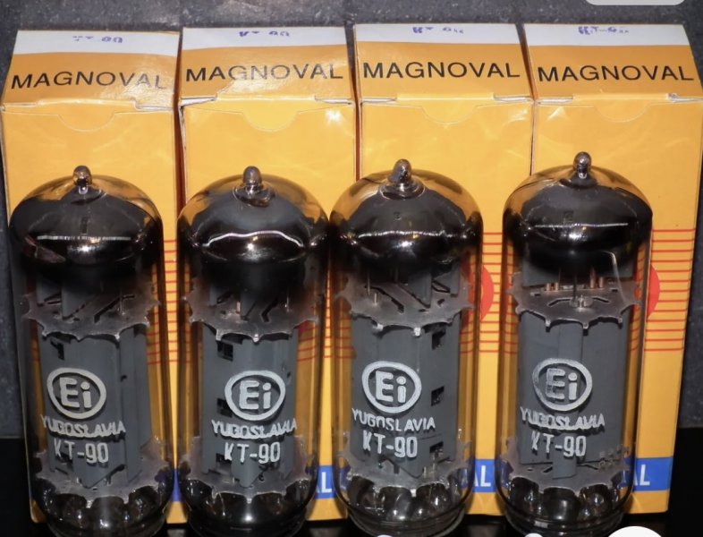

Does anybody know the significance of the Magnoval brand of Ei KT90s?
Does this box provide any insight into which series of Ei KT90s these are?
Magnoval is just a name for European socket type of tube. don't worry, everything is fine

So this suggests the Series II -- blue ones -- are the best.

Ron, this document penned by EveAnna Manley is well known and refers to the design modifications to the second production run as per my post a little earlier , whilst this revision has become known to as Series II and generic to all production from that time onwards the “Blue“ revision that she refers to merely being the stencilling applied to the valves destined for shipping to Manley.
You may strike gold and find NOS or used Manley ‘Blue” stock exactly as so, however they remain Nis factory Series II manufacture several hundreds being marked simply as Ei in white , as well as many re- branded for other customers , please see previous images of such.

Unfortunately I am not in a position to evaluate myself the numerous additional welds inside the tube which signify a Type 2 tube.

Can you discern which type number his tubes are?
His tubes do not have the spot wells on the plates and appear to have the extra “wings” that EveAnna mentions. I would say type 3.
All “type2” have the spot welds no matter if blue label VTL, , white label EI or gold label Gold Aero KT99, although EveAnna describes the latter as tubes VTL did not accept
