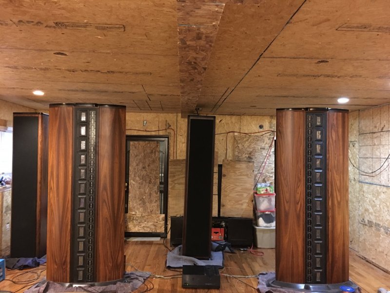

Two people gave me the wisdom of helping and understanding the phase issues of the line source woofer towers
Gary koh first and one of his Facebook friends
I made under his advice an adjustable phase
Device for the woofer towers
This allowed me to dial in a phase for each tower separately to have each cancel the other
This results in an extremely detailed bass and no boom.
it worked and not dsp per say simple electronics used
shown in the pic is before room was finished
Woofer tower in middle and to one side
ill bet if Ron were to sit to one side all the way his bass would completely linear
And if he would standup up and walk left to right he would hear the changes i speak of
My room is 9 feet high 20 feet wide and 55 deep
end game and as 20 feet from front wall to back of towers
my seat 8 to 10 feet
With the Balance of the room behind me.
this solves the bass bump
moving the seat closer or further effects the bass wave. not a phase wave but acoustic waves
Up and down at distance from towers
