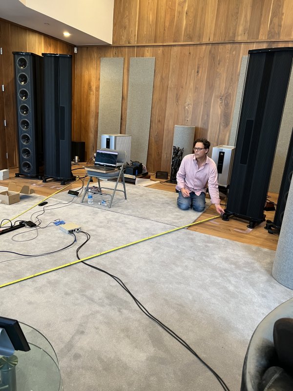

J.R. Boisclair, of WAM Engineering, has been staying with me since Tuesday night. He works 12 hour days.
He is very meticulous and patient, and measurement oriented, but guided ultimately by how it sounds in the room to himself and to his client.
I agreed that pretty much everything is fair game, and, since yesterday after lunch, J.R. has been working on speaker tower positioning. The woofer towers have been moved several times, and the panels have been moved many times. Lots of experimentation has taken place.
We ended up with the woofer towers inside of the panels! o_O We ended up with the AVAAs flanking the listening chair like bodyguards.
The 45Hz and 65Hz room modes have been partially mitigated. A peak in the 4kHz to 5kHz range has been largely remedied.
J.R. wants me to put four foot square absorption panels on the front sidewalls by the ceiling. I will do this.
J.R. is best known for turntable set-up and cartridge alignment, but he is equally expert at room acoustics and loudspeaker positioning. I am extremely happy with his services! Plus, he's a very nice, fun, smart, normal guy.
If you have any questions about J.R.'s services or his process, please do not hesitate to ask me.
