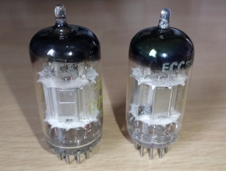

As for warm, communicative 12ax7 for your Jadis, I recommend the Amperex long plate ECC83 mentioned above, or the very early (pre 1951) RCA black plate, or the Raytheon 12AX7 black plate. If you can use 5751 (and most amps using 12ax7 can), the Sylvania 5751 triple mica grey plate, gold pins would also fit the bill.

If the first gain stage in the Io is a 12ax7 you can (even must) do better than the Sovtec LPS even if it is the stock tube. Yes they are quiet, but so dry and sterile (of course in my opinion and in my system where I have tried them in both my amp and my Coincident Phono preamp). The first gain stage of the phono preamp are the most important tubes in the entire system (phono based ) with the greatest amplification factor. This is not the spot for introducing warmth or any other colourations. This is the spot for an extremely linear tube. Like Telefunken ( 803s if you can find them, otherwise smooth and then ribbed in that order of preference), or a Siemens long plate or Siemens triple mica. Low noise samples are still common. My Teles and Siemens are just as quiet as the Sovtec LPS or new “Mullard” reissue (that Isreal supplies with the unit) in the first stage in my phono Preamp. Not the spot for a Mullard (except for maybe an early long plate, dont have a good pair to try). Again in my opinion based on my experience having collected 12ax7s (and 5751) over the past 30 years and using them in my gear.
Another (cheap) option to try is the JJ E83CC frame grid tube. Don’t laugh, this tube is competitive with most NOS ( make sure you get that exact tube, JJ makes at least 10 different 12ax7s and the others are not nearly as good).
Don‘t know what the 6SN7s do in the IO, but there are certainly more linear tubes than the RCA (although they are warm and beautiful in the midrange) like Sylvania 6SN7W or brown base 6SN7WGT.
