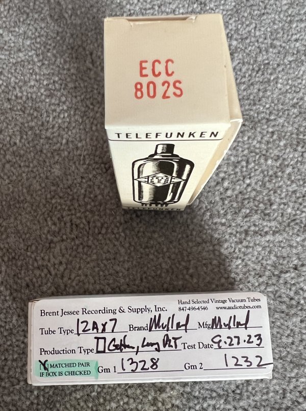

Very meticulously, yes. And the tube sockets, too.
And I don't touch the glass.

Sometimes there is a completely banal explanation for this. E.g. Siemens tubes have thicker pins than Telefunken tubes (noval sockets 9 pin). Simply bend the thinner pins slightly to make it harder for the tubes to go in. and the noises disappeared. If you don't believe it, take a caliper.
I believe you! It makes perfect sense.
The problem socket is occupied by a Mullard 12AX7. Do Mullard 12AX7s tend to have thinner pins or thicker pins?
Have they settled in a little since their introduction Ron ? , If your signature presentation remains a tad hot for your taste, you might have to reconsider the Telefunkens!
Or I would just put back in the Mullards I have been using that I think are slightly less fancy than these new NOS ones.
Pity, you have the original boxes and I have the original tubes that go with them;). I only have follow-up boxes. Have fun with your nos mullards.
