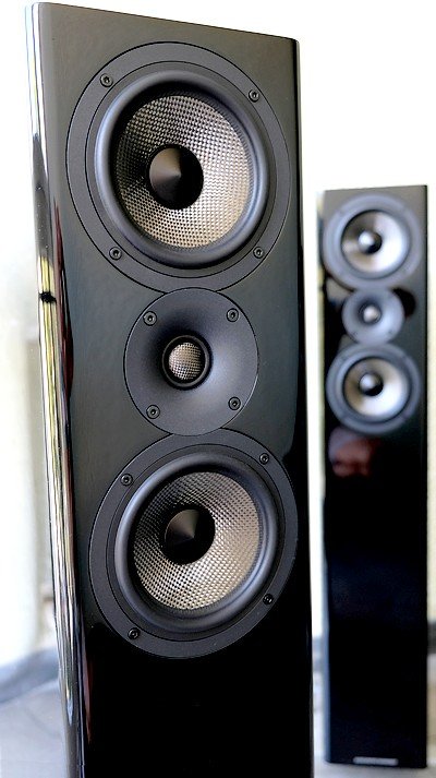

Yes it lacks a symmetrical array to control the radiation pattern, therefore your setup is quite different from a D’Appolito configuration.

A D'Appolito array is a specific configuration of drivers. All we are saying is that your speaker system is not a D'Appolito array, and it is not similar to a D'Appolito array.
It is totally okay that your speaker system is not a D'Appolito array. :)
Totally different acoustic centers vs D’Appolito . Take one of the lower horn woofers and place on top of your Hi frequency horn and Bob’s your uncle ...!
Regards
Correct. In addition to the Midrange-Tweeter-Midrange drivers’ arrangement, there are driver center-to-center spacing requirements to address lobe tilting and to maintain a point source polar radiation, typically a 1/4 of the lowest frequency’s wavelength center-to-center spacing.
Technically, a true D’Appolito also uses a third order crossover as the crossover type affects the lobbing tilt.
Not always Morri , many designs used 1st and second order , Dunleavy for eg used 1st order slopes , excellent step responses..
Perfect D'appolito is almost impossible if the distance between the drivers is too large. acoustic energy speakers do this excellently.listen to this then you know how good it sounds.

The original design by Joe D’Appolito was with 3rd order crossovers, I discussed it with him in person back when he was designing for Usher loudspeakers.
