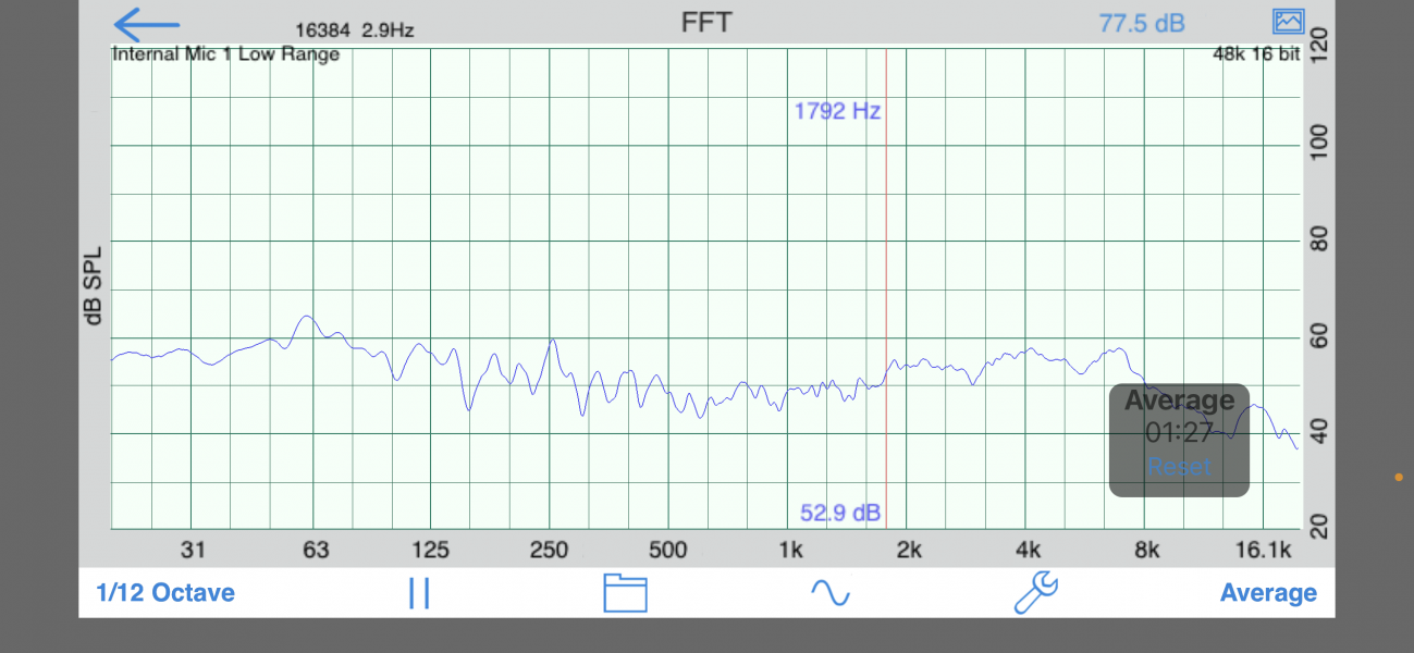

With a peak / bump at 60-65Hz… Do you find that you then have a dip at ca 30Hz ?
no, not obviously anyway

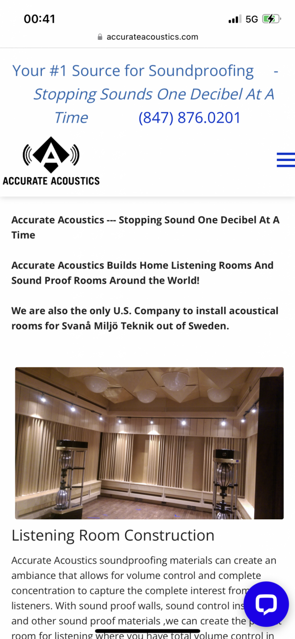

Who makes a free-standing Helmholtz resonator which will absorb with a sharp Q at a center frequency of 60Hz to 65Hz?

Here’s link to the U.S. dealer for the Swedish made Helmholtz resonators with ajustable ports.. Hope it might be of some help.
All the best

Very good Ron,
Seems that the sound has even out a bit now. Much better than before… Have you done anything in particular?

I reduced the toe-in. (It slipped my mind that I used to position the Prodigys pointing straight ahead (zero toe-in).)

And Russ Stratton radically reduced the woofer level. (I told you I was having too much fun with the woofer level control!)
There is still a suck-out in the lower midrange. I can hear it on Stevie Nick's voice. Hopefully that is the ribbon drivers needing to break in.:confused:

Ron,
The vertical scale of the second graph is also changed, creating a false impression of the changes. When comparing graphs we should have the same scale.
Good catch! I did not notice that! The first one was from Russ' app.
I will re-do it later.
