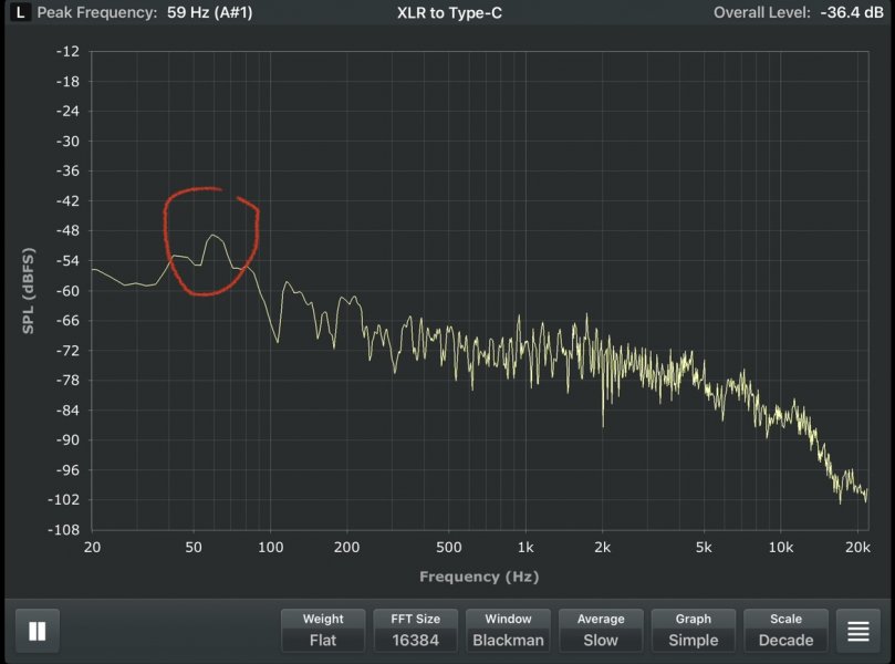

Jason Hanan, President of Pro Audio LA, and his colleague, Richard, visited me today to give me a demo of PSI AVAA active bass frequency absorbers.
Coming as they do from the pro audio world, as opposed to the audiophile world, I expected the AVAAs to do something unambiguously. And they did!

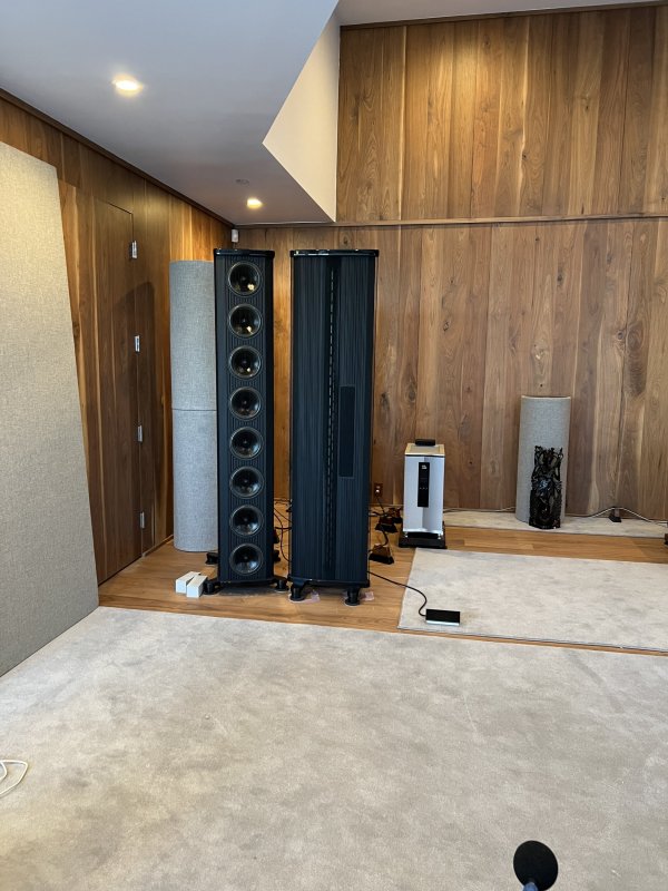

I was expecting Jason to plop an AVAA in each front corner, and he did, indeed, start there. But he is a very experienced professional at walking slowly and carefully around the room with certain frequencies playing, and feeling the pressure nodes of the room at different frequencies.
Jason determined that the front right side of the room has a node at about 50 Hz, while the front left side of the room has a node at about 60 Hz. He thinks this is due to the asymmetric ceiling height caused by the 9' ceiling soffit on the left side of the room (versus the 14.5 foot ceiling height for the rest of the room).
Impressively, Jason experimented not only with different locations and different frequencies for the AVAAs, he integrated a lot of experimentation with my inventory of ASC TubeTraps as well. He likes having both of these acoustic tools at his disposal to identify and mitigate room nodes.
Jason spent a lot of time having his colleague, Richard, slowly rotate the TubeTraps' absorption side versus diffusion side orientation to maximize the mitigation of sound pressure areas.
Jason believes that my 60Hz (and 50Hz) problems are primarily a function of room dimensions, and not a function of woofer tower positioning.
BEFORE
AFTER
We listened to two songs and I could hear a significant improvement. On those two songs there was no longer any obvious room boom.

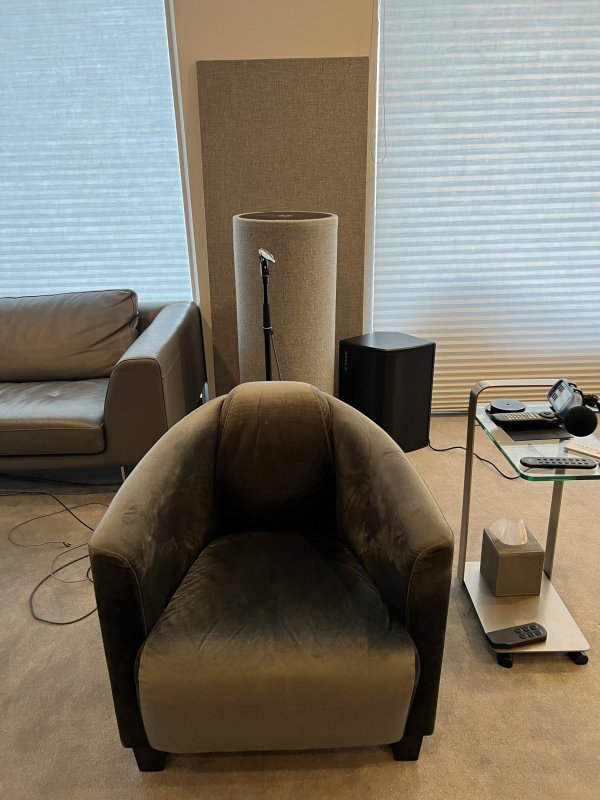

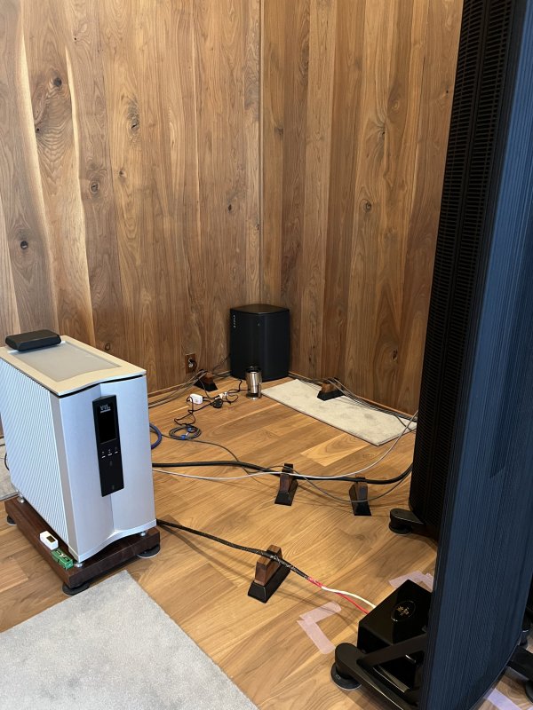

One AVAA wound up in the front right corner, and the other AVAA wound up just behind the listening position. I may order a third AVAA for the front left corner.
I am going to have put tape around the TubeTrap positions, as well as preserve the absorption/diffusion directional orientations. I am afraid to move or tinker with anything, lest I lose the results we have achieved thus far. The TubeTraps look to be a little bit randomly scattered around the room now, but they are positioned carefully to absorb the pressure nodes.

I should remind y'all that with the woofer level control I can bring down the entire 20 Hz to 100 Hz range to make it more level with the adjacent 100Hz to 300Hz section of the frequency response curve. But as long as I don't hear the bass bump, and as long as there is no blurring of low frequency detail or texture, I am happy with a little extra measured oomph below 100Hz. I'll be curious to learn if I actually hear that extra oomph at the current woofer level setting now that the bass nodes are being addressed.
I will play with the woofer level control as time goes on.

Did Jason use a measuring device .. I woud be interested to see how it correlated with Ipad.
It looks like you have smoothed it out right through the range .. thats great !
Does it sound sightly less reverbarent now ?

I don't think reverberation time was a problem. Jason found the room overall subjectively to be on the "slightly live" side, but that's exactly where I wanted to end up.
A certain electric keyboard key in Sarah McLachlan's "Witness" lit up the room boom like a Maglite. I have to check to see how that song that sounds now.
