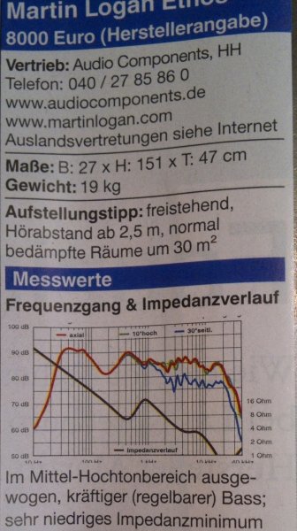

That is a real measurement of the Martin logan Ethos. Look at the same Impedance drop to under 1 ohm at 20Khz.

The decrease of the impedance of panel electrostatic speaker versus frequency is due to its capacitive nature. Panels behave like capacitors - typical capacitance can be around 1000 or 2000 picoFarad - 10E-9 to 2x10E-9 Farad. The impedance of this capacitor in reduced by a factor approximately equal to the square of the turns ratio of the matching transformer. Most probably ML made changes to the panel capacitance - capacitance increases with area and increases with the decrease of panel spacing.
Now for the practical aspects. Measurements of large curved panels taken near field are misleading - the Stereophile review of the Martin Logan SL3 http://www.stereophile.com/content/martinlogan-sl3-loudspeaker-manufacturers-comment-part-2#KDoyier3LIxbUvG2.97debated this subject. Small changes in panel orientation can work as a powerful treble controller. It is why we have reports of excellent sounding Martin Logan panels used either with amplifier having high damping (low impedance output) or low damping (most tube amplifiers). The key points are the capacity of supplying reasonable amounts of current without distortion and proper speaker set up. As always, people must try, although I would not advise connecting the Neolith's to Futterman's ...
