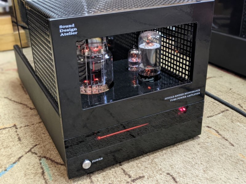

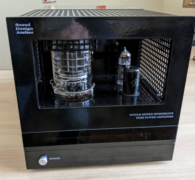

If you have the desire and the opportunity to listen to tube SET amplifiers, you can do it at the Radisson Blu Sobieski Hotel, Warsaw from October 28 to 39 in room 411. You will see that the SET can give a lively and energetic sound.
6?33? and GU-72 will make a great impression on you.

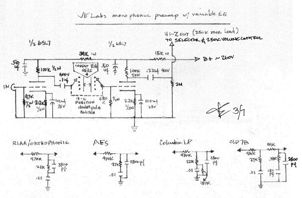

Starting on the right is my mono hifi with a Gray Research HF502 turntable + viscous damped tonearm, which feeds a mono preamp with a variable EQ 6SL7 phono stage. I use a Denon DL102 for stereo LPs + GE RPX and VRII for old mono LPs and 78s. The main speaker is an Altec 756B in a slant front 2.5cf custom cabinet augmented on top by an Altec 32C horn + 802 compression driver. This is currently driven by a 2-stage SE10 amp with Tamura F7004 nickel output transformer. I'm hoping to finish two more amps for this system this winter - a mono SE2A3 with Hashimoto OPT + a mono SE46. On the left corner is my alternate mono speaker, a GE 12" co-axial speaker from the mid 50s housed in a vintage DIY corner cabinet.
