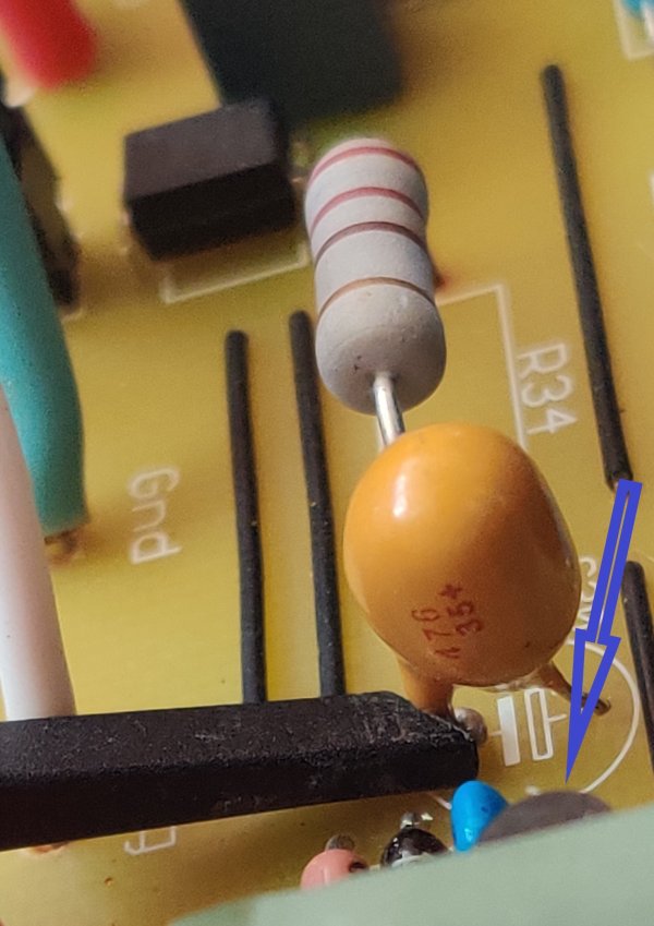

In november 2022 my VA350 once in some days, went into protection. Waiting 30 seconds, it was working again for lots of hours.
I measured the bias again. It was a liitle low, but my biaspot was almost on its end. I was suspecting the T100 tubes would be done.
I somehow got the email adress of the designer of the KR audio amps, Marek Gencev. I wrote him an email at sunday evening, which he answered on monday morning at 7.30h
The bias for VA350 is 1.10Vdc. If the amplifier goes into a protection even with correct biasing you should check thermal stability of TL431
(-30Vdc), which I did:
The TL431 is in the blue circle.
The -30Vdc can be measured at the Tantal cap, the yellow blob left to the TL431.
You can see the measure-probe on the left side of the Tantal cap. The blue arrow markes the TL431. As I heated the TL431 with a hairdryer, it was clearly visible that the voltage got from 29Vdc (cold), to 26Vdc (warm).
So, I ordered the TL431 and all the caps on the main PCB, as one of the 450V caps looked strange (see first pic, left to the TL431)
These are 4x 47uF/ 450V (RM7,5mm , H31,5mm, Ø16mm)
6x 47uF/200V (RM5mm, H20mm, Ø12,5mm)
2x 10000uF/16V (RM7,5mm, H40mm, Ø18mm)
All together some €15....
After I'd changed all, the bias was good again. I adjusted it and checked for several days if the bias was drifting. All was as should be.
When I got to do the listening, I was very surprised at how much better the VA350 now sounds!! More dynamics and the soundstage opened wide now with lots of layering and soundstagedepth... Very very nice!! A friend of mine who was here just before and direct after the modification said it has transformed my system. I was still thinking, it would be my room-acoustics and my speakers, not being able to layer well, but here it is :cool:
So, when someone has a KR Audio amp (the main pcb is almost the same in all amps. The TL431 is in all of them) he should check the bias and look for the drifting TL431.

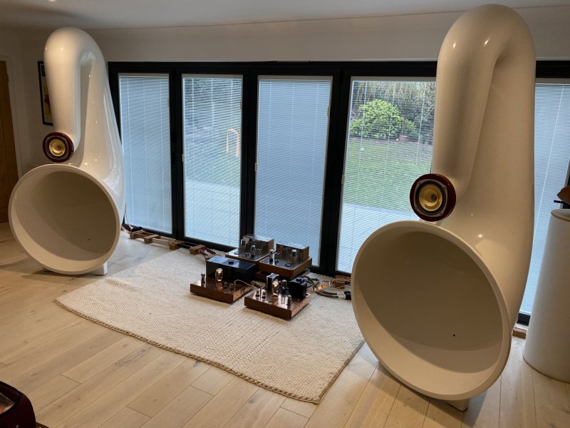

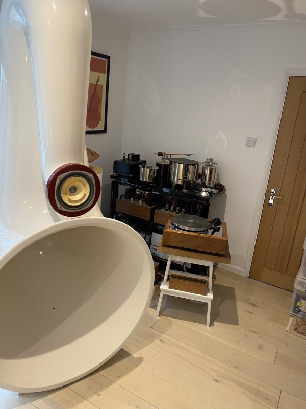

At Bill’s, experimenting with Audio Detail GM70 and 300b and comparing to existing 801a amp. The 70 was excellent, very transparent and gets the musical lines with letting out just flow. those who listen to my also heard this on recent hORNs universum videosE7DD80DE-166B-4514-A2DD-5FBE89011A20.jpeg
Dava on the horning SATI Dynavector arm, vdh master strad on SME V on a TD160 that Bill put a wooden plinth on.
the white horn colour integrates very well with the light floor and light wall colour and the glass door
