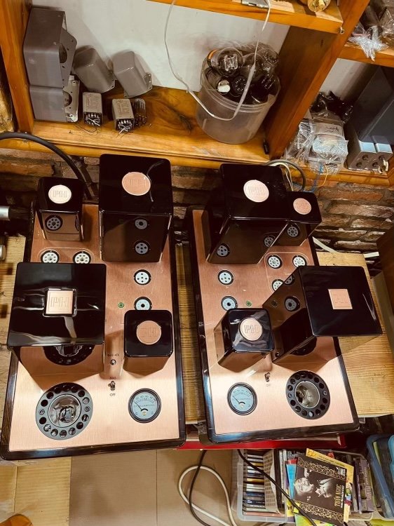

An audiophile friend and I worked with an experienced and talented amp builder who my friend was familiar with and came as a trusted source.
We have had three amps built over the last year:
1) VT25 driving 211 (13 watts)
2) E55L driving 211 (13 watts)
3) DET 25 driving DET 25 (8watts)
so 1 & 3 are SET driving SET
They are all built as monoblocks
They all have both single ended and balanced inputs.
They are all fully tube rectified
They all have choke loaded power supplies
There are no capacitors or resistors anywhere in the signal path
they all share the same design where the power tube is rectified by an RGN 4004/U8 type tube (and variants) and the Output tube is rectified by 4- GZ34 (and variants)
the build requires the transformers and chokes to be custom made for the tubes and circuit.
As an example, we run the 211 tubes at 500v based on design choices
both 211 builds are copper wound transformers and the DET25 is silver wound.
the DET25 has not been delivered yet so I can’t comment on the sound and have never heard this tube before…I actually had never heard of this tube before.
both versions of the 211 have been in our systems for 6-9 months. They are dead quiet and sound very good. Based on my experience, this build really let’s you hear the tubes. So, as an example, the difference between an STC 4242 and a WE 242 or a telefunken 237 is very apparent.
I’ve heard the amps with Devore O/96, Audio Note ANe/SEC silver, Honing Ellipse and my current speakers which are DIY horns using AER/BD3 and Supravox 285EXC field coils. These are not yet finished as I am considering finishes and trying some different configurations.
So, I encourage you to pursue this path…results have been very rewarding for me

These look fantastic thanks Glide3. You’ve really thrown yourself into this. Looking forwards to hearing about your discoveries with the new DET25. Great stuff.

Those amps are simply beautiful!
