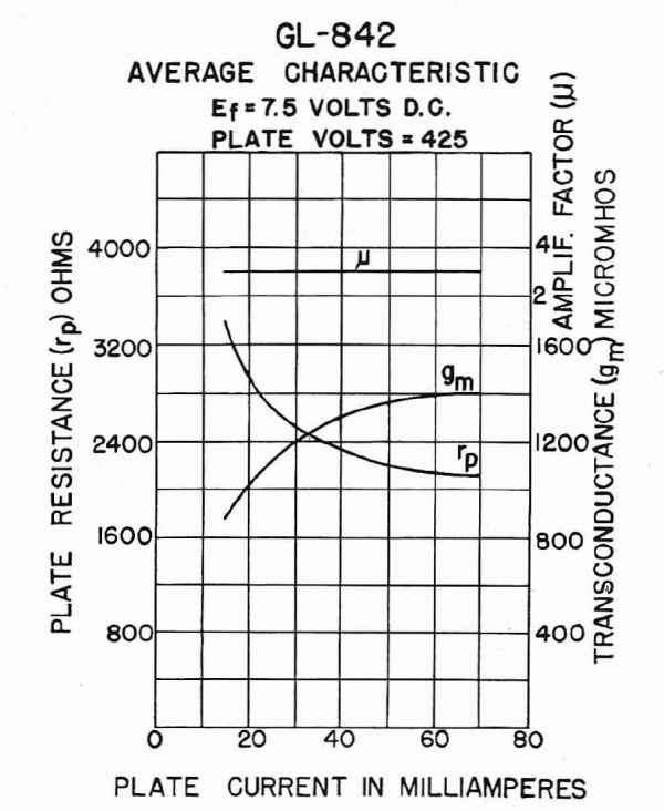

Very nice tubes indeed and also very linear. But I yet have to see a indirectly heated tube which can really match a DHT in linearity. I do use IDHTs and yes they simplify circuit design, but the DHTs are just a notch better and are the only choice for me in the top amps. It is worth the extra circuit complexity needed for the filament supplies to get them totally quiet
Stevie Bench ran some interesting measurements years ago which showed that the amplification factor remains more constant in DHT as in IDHTs. The latter showed a slight compression effect while the DHTS mu remained constant with signal amplitude. Stevie was the first to analyse this AFAIK. Interestingly the thoriated tungsten filament tubes were best in that regard, followed by oxide coated DHTs and then indirectly heated tubes. Kind of matches what I hear.
No using IDHTs is not blasphemy. This has nothing to do with religious beliefs but experience. I am happy to use IDHTs and they have their place. For example I used a lot of 6CB5As TV tubes in amplifiers as output tube. But it is a compromise IMHO and my best amps only use DHTs, also as driver.
All just IME and YMMV
Thomas
See attached excerpts from GE data sheets. One shows a DHT. See the ruler straight curve for the mu. This is a 842. The other is the 6BL7 see how the mu varies. Unfortunately they started late to include this curve
