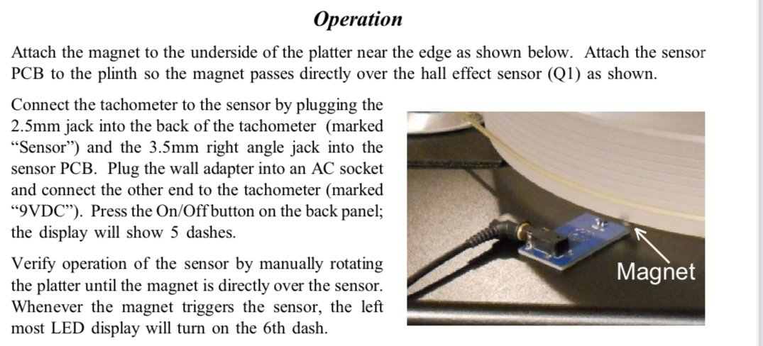

The sensor needs to be placed underneath the platter. I used a small piece of wood to which I attached the sensor and I placed it behind the plinth with a small patch of blue tack between the piece of wood and the platform so the sensor would not move.
If I understand correctly you use a block of wood to raise the sensor above the plinth (1 24/32") so it reaches to within 1/8" of the magnet on the bottom of the platter?
Did you glue or double-stick tape the block of wood in place on the plinth? (I am afraid it will look DIY.)
Yes. The block of wood was not on the plinth but on the platform on which my Balance TT was residing. I used a very small patch of Blue Tack to make it stick to the platform. The magnet is delivered with a soft removable glue.
Reactions: Ron Resnick
Sorry, my mistake. Yes, I meant the platform.
Ron, my whole TT rig has a thrown together look (let's not think about the sound), so a somewhat higgledy-piggledy SOTA Condor/Eclipse/RoadRunner speed tach/motor lash up here is no problem aesthetically.

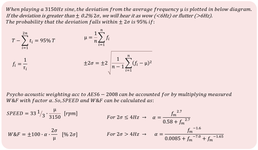

W&F is defined by two major things;
  • how much (how many +/- Hz) the speed deviates from the average speed. This is called the frequency deviation. Let’s call it Δf.
  • how fast the speed moves from and to the maximum and minimum deviation. This is called the modulation frequency. Let’s call it fm.
Wow is simply defined as fm<6Hz and flutter is fm>6Hz. Frequencies below 0.5Hz is called drift and it’s a different topic. Flutter is normally measured up to less than 100Hz.
In order to measure Δf and fm we use a carrier frequency, which is the average speed of the track (the groove velocity) on a test LP. It’s an old habit to use 3150Hz sine which seems a bit odd, but it’s the midpoint between 1 and 10kHz on a log scale paper. Let’s call the carrier frequency fc.
Music is not pure sine waves but instead a compound of very complex waveforms and transients, so in a similar way as we use rms values and not peak values to denote magnitude of varying levels, it is common to use a value of the deviation Δf which is not exceeded 95% of the time (of a measurement). This is called 2σ (two-sigma) i.e. two standard deviations of a normal (gauss) distribution.
I made a summary illustration;
Our hearing is normally most sensitive to a frequency deviation of 4Hz. So, it is most annoying if a 1kHz tone is meant to be pure but sways between 996 and 1004Hz. If it sways less or more than that, it is less annoying. Therefore, a weighting factor was expressed in AES6-2008. We can call this factor α.
Again in my opinion, based on all the above, we should help ourselves in trying to stick to one common nomenclature, e.g. w&f % 2σ weighted AES6-2008 test tone 3150Hz.
If we do that, a sensible requirement based on human perception is then to not exceed w&f +/-0.2% 2σ.
It is very easy to measure a signal for the analysis of speed, wow and flutter. But it is quite complicated to calculate the W&F. For most disturbances or properties of sound, we can use filters and/or FFT to extract the information. But for W&F we can’t do that because the signal is frequency modulated. The W&F is inherent in the signal. Therefore, again in my opinion, it is important that the tool maker states the method used to calculate the W&F.
To conclude, if we assume the speed deviation has a normal distribution, the following should be measured and calculated for a turntables speed, wow and flutter. τi can be regarded as the individual periods in a measurement (i.e. the inverse of the instantaneous frequency fi):
The requirements we should put depends of the standard of the player and is in the end up to each of us, but for a good standard turntable I would recommend:
  • 33.0 < SPEED < 33.7rpm
  • W&F < +/-0.2% 2σ weighted AES6-2008
The test record (and all our LPs) has some warp and the center hole is never perfectly centered. The record player shouldn’t be blamed for that, so 0.55Hz wow (33rpm) should be disregarded or filtered out.
