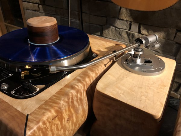

Does anyone know where I could find an anti-skate mechanism for my series-1? I am getting some distortion on the third band of the Hi Fi test records bias track. I don’t hear it when I’m playing music, but do wonder.
Most cartridges will generate some distortion in this high modulated 300 Hz track. Try listening to each channel individually - do you perceive significantly more distortion in one channel than in the other?
Thanks for your response Microstrip... Yes, I only hear distortion from the right channel when playing the test track.
