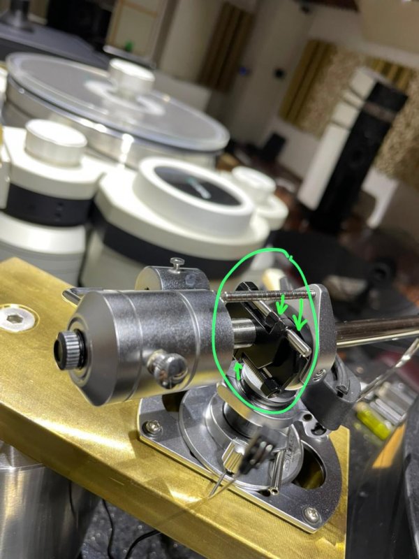

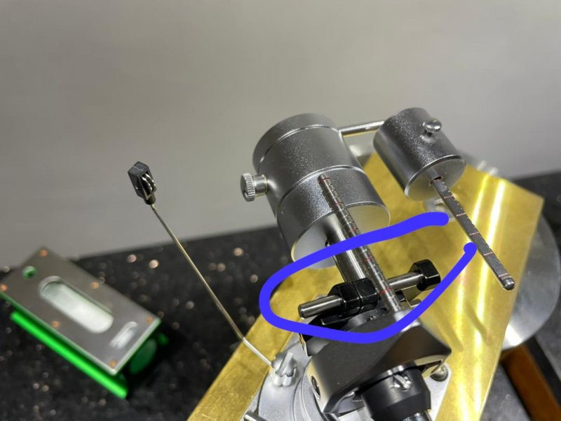

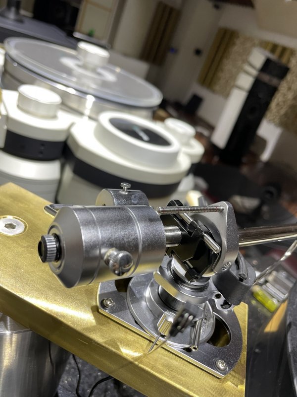

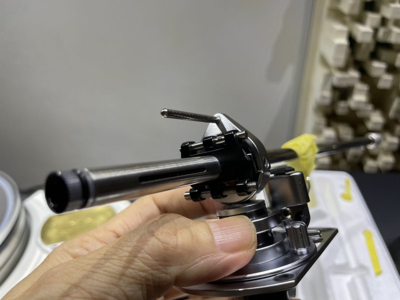

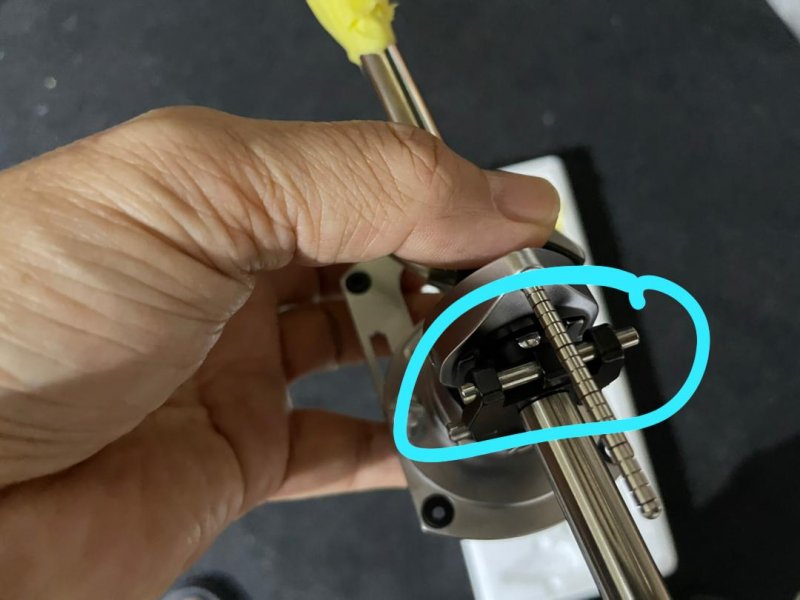

Bought 2 SME 3012R after reading abt the massive interest in this thread. Was thinking some of your guys with high end tonearms couldnt be wrong. However I have a bit of problem with lateral balance of 1 tonearm with the horizontal bar jutting out all the way left .. Where else another arm the horizontal bar is fixed centrally making lateral balance adjustment easy to manage. Refer to photos . Is the 1st tonearm normal ( left) ?
Read the manual, that’s adjustable.
So I am asking both tonearm looks different .. normal ?

The “jutting horizontal bar” is adjustable laterally. This is what you tried? You’re saying it’s stuck and won’t move?
The top bar is not adjustable . Is fixed . The bottom bar is adjustable for lateral balancing .
If u check the photos carefully, both of them are quite different
Audioblazer, I have owned three 3012Rs. The first one had the top bar jutting out far to one side. I found that I could simply push it back with my hand and mild pressure. I think this bar is only to keep the contraption aligned. The lower bar is the one that is adjustable with the allen wrench and what moves the counterweight assembly laterally. The top bar is only for alignment and works as a guide. You should be able to push it back in from one side so that it is more centered. It is smooth and only attached by friction to the plastic parts.
