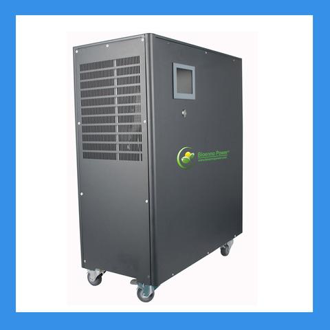

Curious what you all think of this non-audiophile solution. It's only $4K and doesn't look too bad. They do offer a similarly spec'd version to the Stromtank that retails for around $5,500, but it's currently listed as out-of-stock.
I can't really see why this one costs $5,500 and the Stromtank is $30k but maybe that casing justifies the insane premium.
I'm chatting with a company willing to do a one-off solution to my spec for about the same cost here plus whatever extra cost for different components/materials. I run SET amps, so my system isn't as power hungry as other systems.
I'm curious what "requirements" you'd recommend for a system like mine?

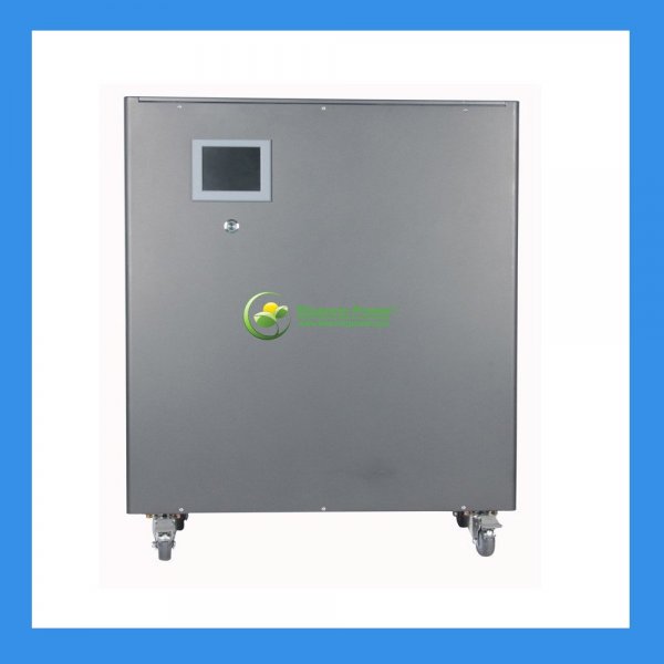

https://www.bioennopower.com/collec...ation/products/4000-w-hr-power-pack-bpp-4000p
This version actually exceeds the Stromtank in pretty much every area. What we can't see in the specs is distortion or how well they recreate the sine wave. Still, seems like a much more cost effective solution for those looking to go this route.
Also, in case of a zombie apocolypse, these have the ability to be charged by solar panels. And who wants to face the end times without their HiFi?!?
https://www.bioennopower.com/collec...oducts/copy-of-6500-w-hr-power-pack-bpp-h6500
Price: $5,699.99
This BPP-H8000 On-and-off Grid-tie solar Power Pack is Not in stock. Please email your request to sale@bioennopower.com, and you will be advised the delivery time.

BPP-H8000 Power Pack Specifications
Battery Type: LiFePO4 (Lithium Iron Phosphate)
Battery Voltage: 58.1V
Battery Capacity: 162Ah
Watt Hours: 8000 Watt hours
Weight: 301 lbs. (137 kg.)
AC Output: 110VAC (220VAC Upon Request)
Maximum AC Continuous Discharge: 3000 Watts from Pure Sine Wave Inverter
Peak Discharge: 4000 Watts for 10 Seconds.
Input 1: 110VAC Input (220VAC Input Upon Request)
Maximum VAC Charge Current: 2400 Watts at 60Hz
Input 2: 75V-150V Solar Input (Solar Input must be used within this range)
Solar Efficiency: MPPT >96% Efficiency
Maximum Solar Charge Current: 2400 Watts (3000Watt Upon Request)
Maximum System Operation Temperature: 32°F ~ 104°F (0°C ~ 40°C)
Battery Operating Temperature: -4°F ~ 140°F (-20°C ~ 60°C)
Battery Charge Temperature: 32°F ~ 113°F (0°C ~ 45
Price: $5,699.99
Applications
This multi-function mobile renewable power station for industrial/commercial/residential applications provides a combination of functions including renewable energy storage, major or backup (auxiliary) power supplies, and UPS in a highly lightweight, compact unit. This mobile system with an intelligent control and associated user interface can work in a hybrid mode of (1) off grid ( an off-grid standalone system) and/or (2) on grid (a grid-tie system).
At A Glance -- Product Features
8.0 kWh energy storage and 4.0 kW power output
Lithium Iron Phosphate Battery as energy storage
Integrated Intelligent Micro-Computer Control System
UPS Function (off line UPS Switching time <20ms)
Distributed On-off Micro grid system
Peak avoid mode to save your electricity bill
MPPT Solar Controller
Touchscreen Interface
Multifunctional
Remote and mobile monitoring
Simple Operation and Flexible Usage
Long Service Life and Dependable Performance
Battery Charge Temperature: 32°F ~ 113°F (0°C ~ 45°C)
Cycle Life: > 2000 cycles
Dimensions: 31 in. x 14 in. x 36 in. (779 mm x 347 mm x 912 mm)
