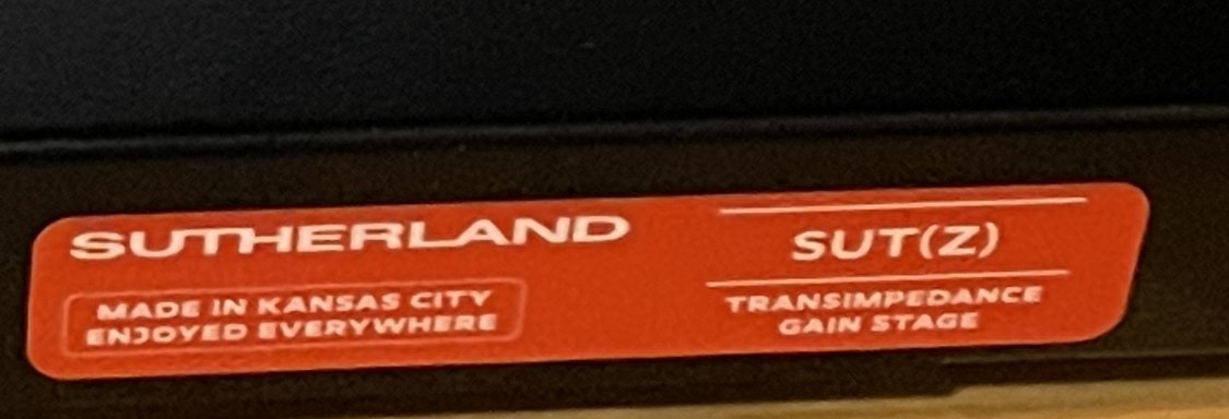

Picked up the Sutherland SUTZ for my other system , I'm using the mm on my VAC master huge upgrade . This is a great way to introduce transinpedence

What is the SUTZ? Layout looks like a Little Loco.
