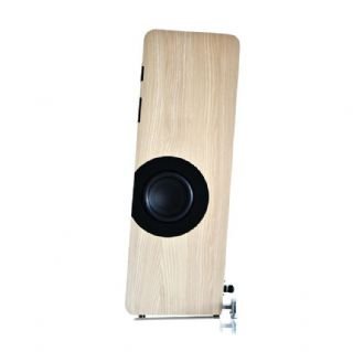

What about use of the Daiza's as Speaker Platforms? I was curious, in particular, how they would perform with a design such as Boenickes Swing Base, which suspends the rear of the speaker on cables and the front on a ball bearing. The concept in their words:
Our SwingBase® (patent pending) allows your components and speakers to move in the horizontal plane with as little friction as possible while offering extremely simple height adjustment. There are many other products on the market, most of them using “isolating” ball bearings (or springs). Since a ball rests on its adjacent surface on a theoretically infinitely small area, either the ball or the surface it sits on inevitably deforms to a certain degree, even under little weight. That clearly compromises the construction‘s effectiveness. Bear in mind: Horizontal friction must be as low as possible!
Our SwingBase® is totally different. Your components will be suspended in free air, held by thin and flexible steel-ropes, pre- senting virtually zero resistance to relative movements, even under heavy loads up to 280 kg*.
Is this method complimentary to what the Daiaz is doing, or would they be working at cross purposes?boenicke-audio-w8-finish-ash-finish-model-se-[3]-10994-p[ekm]320x319[ekm].jpgUnknown.jpeg
It will absorb some cup to floor ringing which might be positive. But Boenicke is definitely in the "including material resonant behaviour into the speaker voicing" camp so it may alter that voicing. I generally do not recommend using Daizas for that type of product.
