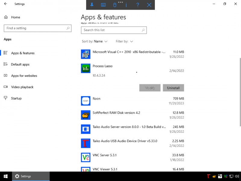

For XDMS Users with 27 Apr Cumulative Update
Quick summary of the sequence is
1) Reboot Extreme
2) Start Roon as a Foreground Application using the roon Shortcut on the dektop
3) Start a Roon Remote and go to Settings, About, Gearwheel and turn off Auto install of updates
4) Install latest 13533 Updates to both Remotte PC or MAC
5) Place the zip file on the Extreme Desktop, and unzip
6) Import new ProcessLasso profile
7) Run PowerShell script
Points 5,6 and 7 correspond to part of the Extreme Operating System update that Taiko staff has to do or is independent. If it is the second case, where can I find the zip to update Process Lasso? I attach a picture of my current version of ProcessLasso in case it needs to be updated.
Points 5,6 and 7 correspond to part of the Extreme Operating System update that Taiko staff has to do or is independent. If it is the second case, how can I get the Zip to update PrecessLasso? I attach a picture of my current version of ProcessLasso in case it needs to be updated.
Yes, that part is our internal procedure, please disregard.
