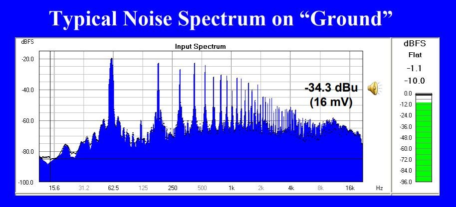

Taking a screenshot from the link I posted earlier in this thread :
http://audiosystemsgroup.com/InfoComm-Grounding2012.pdf
This would indeed be typical for the noise spectrum on your home safety ground, this noise spectrum will also be present on your "ground" wires, component chassis, cable shields etc, for a deeper dive in some of the mechanics I again recommend reading that link.

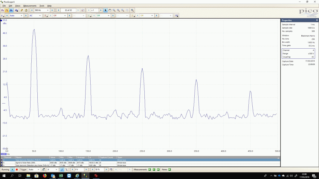

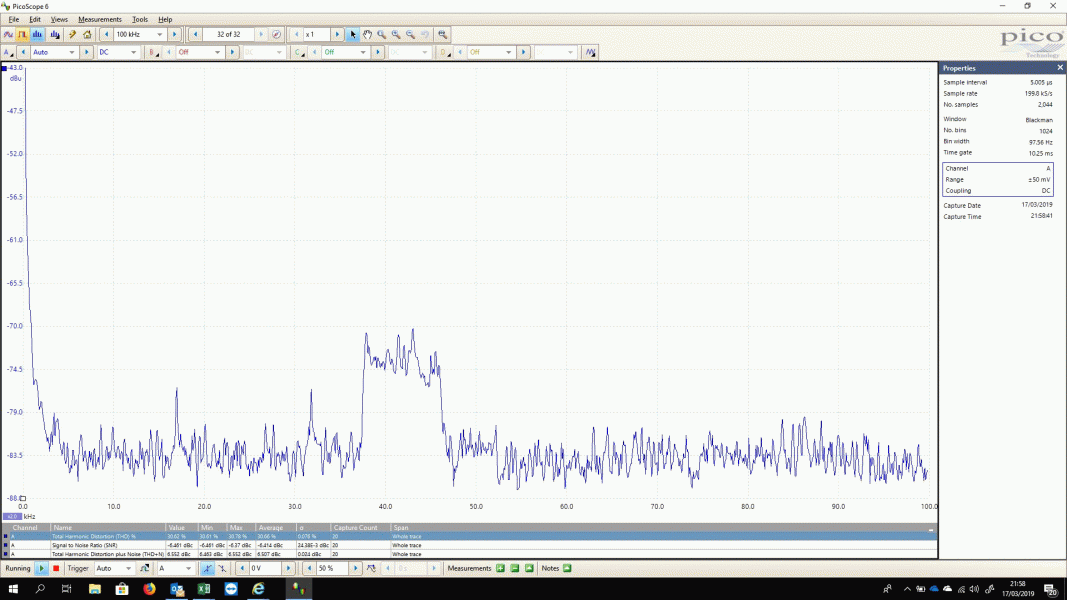

Let's dig into this a little bit further with a few old measurements I took myself which I probably posted in this thread aswell.
Noise spectrum imposed on "ground" from a Linear Power supply, this is caused by the current draw when charging a capacitor bank:
Noise spectrum imposed on "ground" from a SMPS, with a ~37-47KHz noise spectrum, probably has "spread spectrum" applied at a ~42KHz switching frequency:
The point of sharing these is that both a LPS and a SMPS cause "ground noise", more supplies = more noise, but SMPS noise is considered more harmful to sound (with which I agree). Both types of noise will find their way into our systems, and now we're ONLY looking at noise created by power supplies themselves without actually powering something which can significantly change this noise spectrum.

Thanks for the very informative post. It appears I may not understand the graphs well since what I notice is that for the LPS unit, there seems to be "ground" noise with a base of -10dB with spikes of up to 50, 40, 30 etc db every 10Hz starting at 50Hz (Fig 2) . Yet the SMPS has base ground noise at approximately -83dB with only a 10dB spike from 37-47KHz. Yet you suggest that the SMPS noise is the one more detrimental sonically, correct? If so, all else being equal, wouldn't the SMPS noise be easier to attenuate with a well-designed bandpass filter?
Reactions: Zeotrope
Disregard the scale, different probes / measurement setup / did not adjust the software for that. LPS is at 50Hz (Europe), would be 60Hz in the US, the harmonics are multiples of 50Hz.
Missed the second question: they are filtered, to … “ground” , which is why you see this spectrum appear there.
