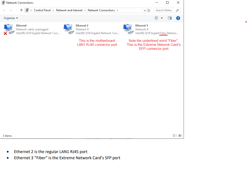

Using one of the links from the recent post from @Christiaan Punter this is what I see. It appears to be different from what should be seen if the switch and card are working. Would anyone have an idea on this? Thanks!
At first glance, the first item in your list “network 7“ shows gigabit fiber, which, according to Christian‘s document is the network card inside the server. (Not the motherboard slot.) And there are no red ”X”s so appears to be properly connected. Are you having a problem?
my understanding from Christian’s document is that “fiber” is merely the designation for the Taiko card, not necessarily indicating a fiber connection.
Everything seems to be working fine but when I looked at the link Christiaan provided (see below) mine looks different. I want to make sure that I'm connected correctly. Thanks, Bob!

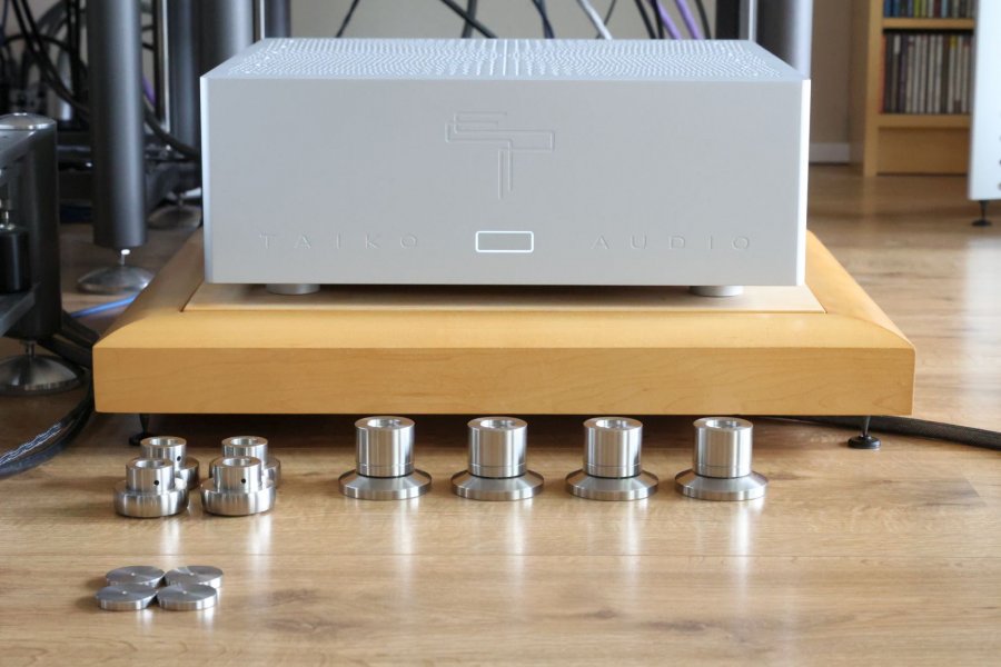

Taiko Audio Extreme Music Server - On Artesania Exoteryc versus Finite Elemente Pagode Master Reference​
After my earlier Footer- and placement experiments using the Taiko Extreme Network Switch it is now time to see what happens when I move the Extreme Music Server from the Artesania Exoteryc Audio Rack to the Finite Elemente Pagode Master Reference Platform.
From the very first instance that the server entered my system, it was placed in pole position on top of an Artesania Exoteryc rack, directly on the beechwood footers that are part of the Carbon Fiber Linear Arms option. These feet are in direct contact with the server’s bottom panel and bypass the server’s own feet.
In the earlier Extreme Network Switch report, I only used the Pagode platform only as supplied, with Finite Elemente Cerabase footers. For this Extreme Server comparison, however, I wanted to be certain that the ideal footers were used, so, in addition to Cerabase footers, I also had Cerapucs and standard spikes at hand.
With help from my friendly neighbors, I moved the Extreme onto the Pagode, which was fitted with standard spikes. As soon as we tapped play (using XDMS NSM and local library content), all three of us were pleasantly surprised!
While the Pagode had not mated particularly well with the CH A1.5 power amp earlier, the match with the Extreme Server seemed to be highly synergistic. Of course, we were now using spikes rather than Cerabase, and the server was now sitting on its own feet, which I’m sure also plays a considerable part. Visually, the Extreme also truly looks the part on the platform that seems to be custom-made to be a perfect fit. The Extreme now sounded more solid and full-bodied but not thick and with a significantly more convincing midrange timbre. The Pagode was not more revealing, rather, it was more concealing but still, it somehow made for a more emotionally involving presentation. Tracks that sounded a little threadbare on the Exoteryc now felt more “live” and more organic. Ultimately, though, the Exoteryc did provide a more high-res rendition with better articulation and higher overall transparency.
Changing the spikes for Cerapuc we were again surprised at the large difference, this time not changing timbre, flow, or the organic nature, but simply improving the articulation, precision, and expression across the board. Now, subtle sounds that had been hidden in the mix (Pink Floyd’s Animals, for example), now stood out much more vividly. The only additional change that the Cerapucs introduced was a more solid foundation leading to bigger bass. But thanks to the increased articulation, this was not at all a problem. I still did not feel the Pagode was as “invisible” or as highly resolving as the Exoteryc, but it was certainly the more “musical”, more emotionally appealing, approach.
Finally stepping up to the Cerabase footers, the sound became so full that the balance was thrown off, particularly because the bass and lower midrange were now too thick. Along with this, we noticed that the dynamic behavior was less spritely and the aforementioned animal sounds were again buried in the mix. How interesting! These feet are rated for a 40 – 500 kg of component weight for which the Extreme Network Switch was indeed a little too light. But the Extreme Server weighs 50 kg which theoretically fits within the range. But maybe these feet only start coming into their own when an entire rack is resting on them?
In any case, whether used with normal spikes or with Finite Elemente Cerapucs, the Pagode Master Reference works like a charm with the Extreme Music Server!
As always, to be continued!
Thanks for the report.
I tried my Taiko Extreme on a Pagode Master ref. mk2 with the regular spikes direclty on the floor like you vs. on a Daiza platform on the floor. For my system/room, the Daiza sounded better. Then I tried two Daiza, and preferred only one.
In my experience, for most equipment, the Pagode Master ref. mk2 ref tends to have a positive effect, not changing the tonal balance, but improving the body of the midrange, making it more realistic. I am currently using two Pagode master ref. mk2, with regular spikes, under my external passive crossovers.
P.S. Also tried a HRS M3X2 and a CMS Maxxum with the Taiko Extreme and preferred one Daiza (for my system/room/taste).

What I have started to do on Customer Extremes is to rename the Adapters, LAN1, LAN2 and Taiko NIC
I was curious to look at the Network Connections and rename the Adapters as Ed described.
My Network Connections are similar to 2ndLiner (see attached image).
Ethernet 2 (Network 3) is the Extreme Network Card, so that would be renamed “Taiko NIC.”
And I am assuming that “Tweaked Ethernet” is the Taiko Enhanced USB Card (formally known as Awesome!).
So would “Standard Ethernet” be LAN1 and “Tweaked Ethernet” LAN2?
USB is not an Ethernet connection. The other 2 correspond to the 2 motherboard Ethernet ports.
