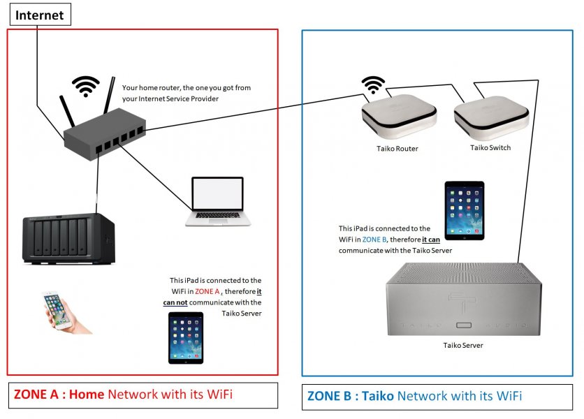

But first, just a touch of vocabulary without going into too much detail.
A router and a switch are two different devices that do two different things.
A switch is used to connect devices to each other within a network.
A router allows networks to communicate with each other.
(It's over simplified, but that's the goal)
In the diagram below, Zone A and Zone B are isolated from each other.
Each zone has its own WiFi.
If you're connected to Zone A (WiFi or cable) you can't see what's in Zone B.
If you're connected to Zone B (WiFi or cable), you can't see what's in Zone A.
This is the purpose of the Taiko Router: to create a network that will isolate the Taiko Server.
Traffic from Zone A does not reach Zone B, and therefore the Taiko Server.
The diagram below is the simplest general layout.
Hope it helps!
Cheers,
Thomas

So I was describing a scenario where a windows pc is connected to zone a through a network cable and zone b through wifi at the same time. If that would have similar performance to the ipad.
It would be similar but the question is how much network traffic your PC creates while connected to zone b. My guess is that a windows PC would create much more traffic than an ipad.
My solution to that problem would be to manually remove the gateway from the wifi connection settings so that all internet traffic of the pc goes to the cable connection and only xdms/roon traffic goes to extreme.
What you trying to achieve is possible but not trivial. It's some kind of application level proxy.
An application proxy, known as ALG (Application-Level Gateway) allows per application routing.
I wouldn't go that path, it simply doesn't make sens in our context.
A workaround would be something like ForceBindIP, but not sure it'll do the trick.
