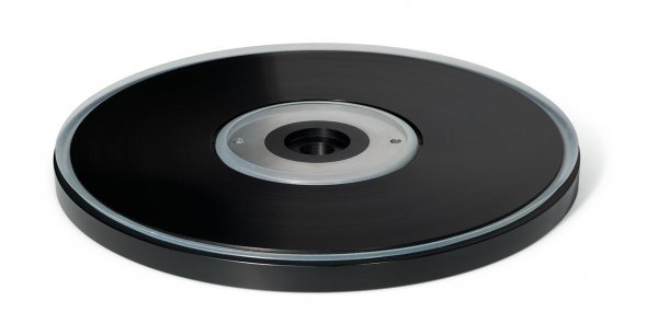

I am curious how they implement the vacuum hold down with TAF1. Remember the Versa Dynamics and how early models ruined the "B" side of albums because of dirt on the platter?
I believe that this was extensively thought through.
If you look at the center "heart" of the AF1, it comprises 3 layers. The bottom screws down into the chassis, the center layer protected by two O-rings is the positive air pressure for the air bearing, and the top part is the negative air pressure for the hold-down.
The platter, then is also separated into two parts. The inner part where the label is stays at atmospheric pressure. This is also so that any dust on the label itself does not get sucked into the vacuum pump.
The vacuum hold-down is only on the playing part of the LP. We assume that you'll keep it fairly clean. If you've got a speck of sand, then the vacuum is going to impress it into your grooves. But this is mitigated by the replaceable, disposable platter sheet which is fairly soft. This sheet also has anti-static properties, and protects both the platter as well as the LP.
One extremely neat trick with the AF1 is that when you turn the suction off and then press stop, a little puff of air pushes the LP up so that it's easier to remove.
