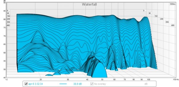

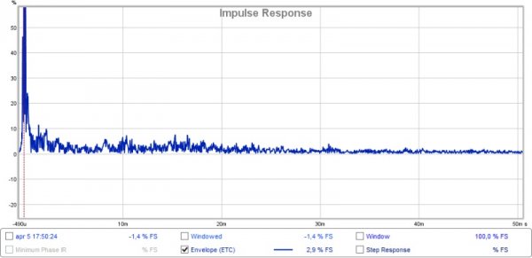

Mostly agree, but the spl level that you get from adding a subwoofer down at the bottom will have to fin nicely into the spl level of the midbass and mid frequenziz. If not you will get what I call one note bass. The blend is important yes, bougth in phase alinment, time and spl.
Would you for example have the same spl rize from lets say 150hz down towards 20hz if you listened to music in 70db at the sweetspot or at 90db in the seetspot?
Here`s two grafs that show my target the woofers is added at 50hz. The long wave in the waterfall graph at 50hz is my computers power. It comes and goes, sometime it`s there and sometimes its not.
I find this very homogenic with no subsound. It only makes the speaker sound bigger and better. An extension of the speakers you may say.
