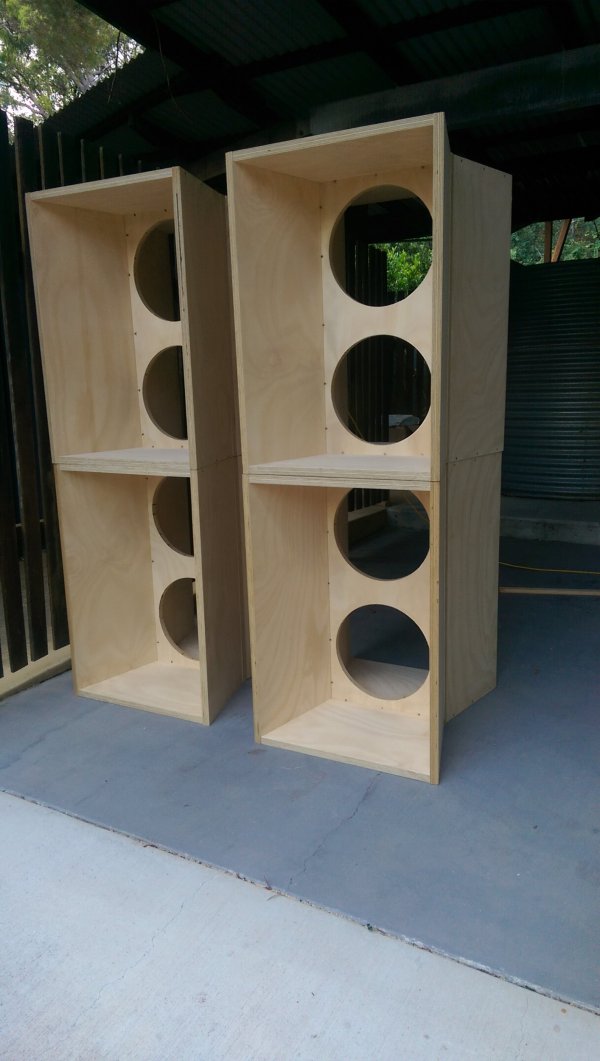

Here is something I am trying for dipole bass ... should have it running in 3 - 4 months and will let you know how it goes .. doubt that it will get chest thumping bass but as there is 4 of them I will be able to swarm them if needed IMAG2065.jpg
They will have 2 x 15" tempest X drivers in each and be shelved via a digital filter
Dipole peak is 170hz and i think the equivalent level of mid / tweeter is about 80db so there is a bit of headroom ... the red is sub and green is woofer woofer and sub.gif

Here is something I am trying for dipole bass ... should have it running in 3 - 4 months and will let you know how it goes .. doubt that it will get chest thumping bass but as there is 4 of them I will be able to swarm them if needed View attachment 80023
Dipole peak is 170hz and i think the equivalent level of mid / tweeter is about 80db so there is a bit of headroom ... the red is sub and green is woofer View attachment 80024
Dual 15" drivers X 4 works for me!
Looking forward to seeing these when they are finished.
Reactions: Zero000
