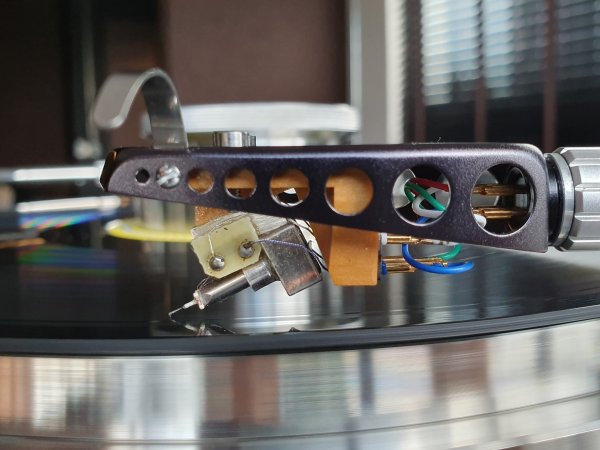

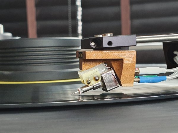

I have two Master Sig. One is Strad with output 0.5 mV. The other is non Strad with 1.1 mV output. Before I sent the 0.5 to recondition I heard not significant difference between them. I sent the 0.5 for recondition after 300+ hrs because I was losing body and low down. Three weeks ago I received back the reconditioned cart. I then moved my 1.1 from the AS2000 to 927 with extra long Axiom and replaced that 3012R with the 0.5. Now the 927 with 1.1 sounds the best of all carts ever been on. Some how I still cannot get the reconditioned 0.5 to sound as good as it did. The signature high, super energetic sound and utmost transparency are just not there while the body andlow down is back. I notice the cantilever of the 0.5 is now steeper than used to and I had to mount the SME higher than used to. I also see the bottom of 1.1 on the big heavier Axiom has a scarily small clearance between vinyl. In a few days I will switch the 0.5 to Axiom and 1.1 to the SME to see how it is.

Wow Tang, those angles look really different. It seems the whole mechanism is mounted at a different angle. Is each armtube close to parallel to the LP surface?

The SME is quite parallel. The Axiom is not, but if you look at the flat top of the cart you will see it pretty much parallel to the LP surface. The Axiom is weird all of them have tube bottom up.

It's hard to tell from the photos, but it looks like the SME VTA is much higher than the Axiom VTA. If they both give non distorted sound, then perhaps the stylus is mounted differently in each cantilever so that each SRA is close to correct. Otherwise, I don't see how the VTAs can be so different.
No distortion on both Peter. Just one sounds a lot better than the other.

Of course, what matters most is the final stylus rake angle, regardless of how parallel the arm appears to be. Though in this picture, it looks like there is a gap somehow between the cart and the headshell. What's going on there?

It is a structure of an Arche head shell. Where cartridge screws mounted is a piece of pentagon pictured in circle below.
This piece is adjustable so you can also tilt to adjust your cart parallel to the vinyl here. Then you fine tune the vta at the stem of the arm turning the knob circled in pic below.
Without knowing more, the difference in performance of the 0.5mv MS could be a function of whatever changes were made in the 'reconditioning' process. A steeper cantilever may mean a stiffer suspension which could mean a lower compliance. My understanding of the 'reconditioning' process has it that you will not get a new box with updated specs. Not saying they are different, but if they are you may not have that information.
Just from the pictures... looking at where the white X former of the coils enters the metal tube, I see the 0.5mv/SME instance is more snug against the metal tube whereas on the 1.1mv/Axiom it is protruding out a bit. I claim no expertise, but just from experience of seeing and trying several MS, this suggests the suspension on the 0.5mv may be a touch stiffer. Again just from experience with those variances, sound can be different as you describe. Please take my comments purely as anecdotal.
Best I can tell, every one of these cartridges is different, and the suspension can be an area of difference. David has seen many many of these carts, hopefully he will comment.
Clearance of the 1.1mv/Axiom is not unusual, imo.
