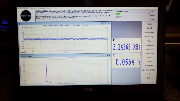

Just ran these. This the SOTA condor motor with no feedback (e.g., RR disconnected) on my VPI Prime:
Reactions: Vienna and Lagonda
And this is the SOTA condor motor with feedback loop (e.g., RR connected) and is consistent with the prior 0.0492% reading which was also with feedback loop.
