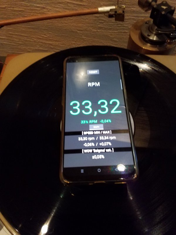

This is my reading from the iPhone app re Goldmund ref ( 35yr old ). It’s the original belt, however I do keep it as clean as I can along with the pulleys. The TT is able to adjust + - .

Very impressive! If it’s a new iPhone, it's among the best measurements. If it’s an older iPhone model, the actual measurement might be higher.
An old belt—provided it hasn’t deteriorated—is usually better than a new one. A new belt tends to perform worse until it’s fully run in, which can take months or a year. The same principle applies to oiling the bearing. New oil must be the correct type recommended by the manufacturer and applied in the right amount to ensure adequate braking. For these reasons, I wouldn’t consider changing the belt if I were you.

I cannot say for certain but usually (not always, usually) Android results are a little bit less accurate. I have no proof of that. IMHO if you use a new model iPhone the result will be higher (worse) than what you get now. I think %0.05 is still great for TD124. I used to have one too.
I think 0.07% is more realistic, is factory spec.;)
iPhone 14
I have no intention of changing the belt.
