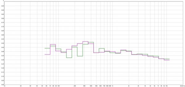

What matters is how the room sounds. It is known since long that the single figure RT60 isolated from room characteristics is meaningless unless it is completely out of normal range. It is only valid in large spaces, not in our typical listening rooms.
Even REW gives us RT60 versus frequency, that can be used as diagnostic tool when treating a room, not as a measurement of the acoustic quality of the room.
