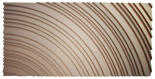

Trying the ZR Acoustics Panels
Not trying to argue but sound is a wave. When a wave hits a boundary only two things can happen. Part of that wave can be transmitted (absorbed) and part of the wave can be reflected. (There is also diffraction if the object/boundary is about the same size as the wavelength) Of course sound (that we can hear) spans a range of frequencies from 20Hz to 20kHz. The percent of the wave that is absorbed vs reflected is a function of frequency depending on what the material the surface is made from. If none of the sound is reflected then it is all absorbed and that is an anechoic chamber. When a wave strikes an uneven surface then the wave will be redistributed in time/space. This is diffusion. The science behind diffusers is to construct that surface such that it produces the most even polar response across a certain range of frequencies.
Now, that wave is made up of trillions of particles (Mostly nitrogen and oxygen molecules) but as I discussed there is nothing these panels are doing that would necessitate or involve quantum mechanics calculations.
I stated above. I don't doubt that their product works and it even looks great. And I think the price is reasonable. But without acoustic data I am not going to believe that it will fix issues below even 200Hz. I don't have to have certified acoustics lab data. I will take REW data from someone's room before and after install. This is not hard to do so why isn't the manufacturer publishing it?
Your comments are from the frame of reference of conventional acoustics. You are talking about how sound "waves" behave when ZR Acoustics claims that their technology works at a level that disrupts the formation of reflected sound waves. Apples and oranges.
From the Sonic Scoop review:
"What makes ZR technology so effective is a trade secret, and Hsu even concedes that they are still developing the proper tools to adequately measure its effects, as they currently do not exist. From what I was able to glean though, ZR works off of a contemporary take on eliminating parallel surfaces in a room, however, it does it on a micro scale: Each ZR surface contains thousands of tiny non-parallel surfaces, which has a broadband effect on sculpting sound waves and their harmonics."
Any trade secret would be in the specifics of how the panels are constructed. There is no trade secret for publishing miraculous data that shows the effectiveness of the product. If the product is that fantastic then it is super easy to publish the data to show the world how well thee work. Go ahead put RPG, GIK, Vicoustic and all the others out of business. The data doesn't have to show how the product works just that it does work.
Don't get me wrong. Audiophiles have debated similar things for cables, powercords and footers for years. Most of us, including me, believe that all of these make a difference in what we hear. But it is not easy to point to a measurement that shows these work. However, it is very well established what to measure in acoustics that correlates to what we hear.
If you have them and are happy with the results that is all that really matters.

I've read the Delta H website and my instincts tell me to beware. Much of the content comes off as a hodge-podge of densely worded marketing-speak with pictures of launching space ships, bullet trains, sunsets, and gifs of Chaos, Tessellation ,Fractals and Fibonacci mathematics.
Unfortunately, any mention of measurements seems to exist in a Black Hole. They seem to be saying that their tech is "un-measurable." If, as they say, their 3/4" panels eliminate reflections at all frequencies, including low frequencies, then wouldn't this be obvious in basic REW measurements? This wouldn't be divulging intellectual property, it would merely be demonstrating that their product is effective. It seems way to convenient...
They do have some impressive clients but it's not clear if these rooms sound good because of these beautiful 3/4" MDF panels, or is it the overall design of the room and additional mainstream acoustic tech that follows known laws of physics?
Everything about this product seem shrouded and impenetrable, which makes me suspicious.
Do they allow a demo period? If so, I might be interested in trying them out, but if not, it sounds like a crazy gamble.

With regard to your possibility #2 above, it is also possible that he understands what he "stumbled on" (at least partially) and is guarding trade secrets, and possibly working on patent applications. With regard to your possibility #4 above panel thickness is not relevant to the ZR technology, which demonstrates again the difficulty of discussing something completely different when we are all steeped in the concepts and terminology of conventional acoustics.
@wil 100% with you there as well but my curiosity will probably get the best of me knowing full well that I'll be taking a risk. I will have to ask them about the return policy if they ever contact me back after my inquiry for pricing.
Note by the way that I found the Gearslutz discussion to be mostly circling the wagons against something new, different, and in the case of the conventional room treatment vendors and consultants, something threatening.
There were definitely two camps for the most part, about as divisive as our current government I must say lol. I understand the logical argument of the critics and even agree with many points but at the same time I want the product to work for my own personal benefit! Only one way to find out besides going to a studio or room with ZR installed.

It seems the cost to buy in is not too bad at all. I am anxiously awaiting your measurements. I too hope that these work unbelievably well!

Funny, I didn't find any of it "shrouded and impenetrable". Some of it is marketing hype but it is pretty easy to get at the substance. Having already taken the "crazy gamble" as I've been reporting, I have satisfied myself that my listening room sounds significantly better solely as a result of replacing a mix of RPG BAD and GIK Acoustics panels with ZR Acoustics panels. What I did specifically was a direct comparison with all kinds of music between several combinations of three 2' x 4' BAD and GIK panels (i.e., three GIK 2" absorbers; three RPG BAD combination panels; two GIK on either side of a BAD panel: and two BAD on either side of a GIK absorber) with four 2' x 2' ZR Acoustics Sample Bit panels. Note that of the combinations of conventional panels two BAD on either side of a GIK absorber sounded best and was the configuration I had used for several years before discovering ZR Acoustics. This evening I ordered another six ZR Acoustics panels - four of the "Hybrid" panels and two more of the "Sample Bit" panels, which will give me the recommended coverage on the walls behind both the speakers and seating position. RPG BAD and GIK panels will remain at the side wall and ceiling reflection points for now.
It's interesting that the ZR panels are suggested to work best with speakers very close to the front wall. This could be good for people whose rooms don't allow for much space for the speakers out in the room. In my case, this sounds counterproductive as I'm now using Boenicke speakers (w/rear tweeters) that are designed to be well out into the room (in my case 10 feet). And, don't most speakers image better with a good space form the front wall?
Reactions: MadFloyd
Speakers behave differently with ZR Acoustics panels than they do in an untreated room or with conventional room treatments. Before I bought the ZR panels my speakers were a couple of feet away from the rear wall. I lost nothing by pushing them right up against the ZR panels/rear wall while clarity and imaging improved, soundstage width increased slightly and soundstage depth was unchanged. John Marks of Stereophile had similar results when he tested the ZR Acoustics panels with his system. Don't know how a rear mounted tweeter would be affected.
