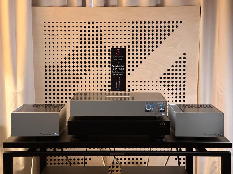

Anyone in Warsaw this weekend please stop by and say hello to Angus in the Lumin/Trenner & Friedl/WestminsterLab suite.
Please also stop by and visit my friend, Sam Wisnewski in the Destination Audio Suite. They will be spinning some great vinyl powered by the DA GM-70 integrated and DA phono stage.
That’s a pretty seductive-looking setup there.

Another room shot from Warsaw show. Sorry, I have the speakers wrong. Last year was Trenner & Friedl, this year it is Gradients from Finland. I might add that it is a very cool mid century modern inspired listening chair!
