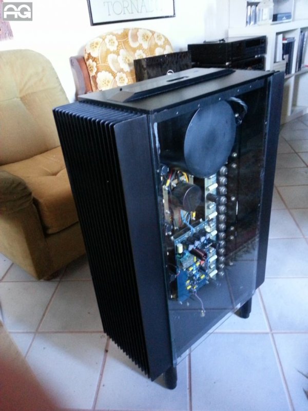

Is it an optical illusion but that amp looks like the size of the chair 2' wide X 3' high? Is it a monoblock?AM audio reference series , you can reduce idle current to 50%.rest class ab mode
Not 700 watt class a /2ohms per chanel. saves energy costsView attachment 133420
Yes,mono amps are among the best amps ever built. Stability at any load.Is it an optical illusion but that amp looks like the size of the chair 2' wide X 3' high? Is it a monoblock?
