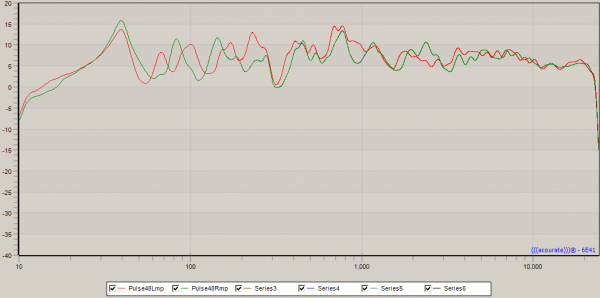

dallasjustice, What do you mean by "No bass"? My mini monitors have an in-room response, as measured from my listening seat, of high 20s Hz. The plot is posted is in my virtual system thread. My mini monitors are sealed, i.e., they don't have a port. I have not noticed a nasty floor bounce. What does that sound like and what causes that?
You have a room mode at about 40hz and probably a few others as well. The above is a smoothed measurement for Acourate which is only designed to prep for DSP inversion. If you measured with REW and posted at 1/12 per octave smoothed results it would be much easier to see what's going on. It looks like both speakers show a cancellation at 300hz. That could be a floor bounce. I don't really know because I don't know about the dimensions of where you sit in relation to the woofer and the height of the woofer off the ground. The room modes help you out a little. But you are down about 15db at 20hz, 10db at 30hz.

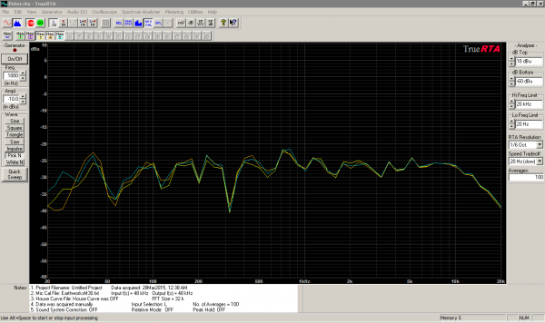

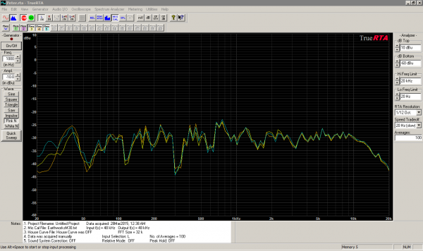

dallasjustice, I was actually thinking of these plots. How would you interpret them? The one you selected was taken with a digital source and I think shows differences between channels while these two are with my analog source and channels are combined but show three different cartridge loading values. I use the blue trace. One at 1/6 and the other at 1/12.

It all looks pretty much the same.
