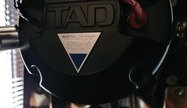

I also have found out by listening that I preferred Radians over TAD's for 2". Radian delivered as much and sounded more relaxed.
I also used beryllium radian 475 like you do but when I tried TAD 2001, they were close but TAD sounded a little better on its own. I use radian 850 for my 2", I decided go for the Radian 475be for the 1" as I thought they integrated better. The bandwidth I use the 1" is also very limited so it is not enough for the TAD to shine and make a difference. It could also be my a priori thinking leading me to believe same brands work better together.
I do not plan to change but first to try the jmlc 270 with 4003 and jmlc 1400 with 2002. If they better what I have now audibly and measurably then I will change them.
