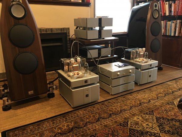

u may be right there ...... but i ended up with these amps and they have the best bass ive ever had in my room - same speakers - PSET though, not SET
