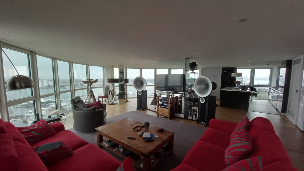

I could place subs close to the main speakers - easier on the left speaker as there's a display cabinet to the right, that could be moved if necessary.
Sadly the ceiling height is a rather low 7 ft 7".

Beautiful room! RELs generally have well-regarded wireless solutions. On the outer edge of the main speakers seems a logical place to start, one on each side. Given the likely dispersion and room-filling capability of your AG horns, I would not be at all afraid to go for some of their bigger flagships or their stacked solutions with smaller subs...real dispersion capability done right in my experience means lower distortion at the same level. Plus, the latter option of stacked subs (with some setup work) might prove to be better in-room in terms of adjustability as each sub in the stack (2 or 3 per side) are then independently adjusted.

  • Not everyone agrees adding subs is necessary. You might want to try optimizing speaker placement and room acoustics first.
  1. Subwoofer Driver Size:
  • You don't necessarily need 12" drivers in the subs. Smaller 10" drivers can work well for smoothing bass, especially if you're not aiming for ultra-deep bass extension.
  1. Number of Subwoofers:
  • Two subwoofers are ideal for smoother, more even bass distribution across the listening area. This helps counteract room modes that cause uneven bass response.
  • With Dirac Live in your NAD M66 preamp, you can potentially utilize up to 4 subs and achieve excellent bass control. However, 2 well-placed subs with Dirac Live can be very effective.
  1. Wireless Subwoofers:
  • Wireless subwoofers offer convenience, but wired connections (XLR or RCA) are generally preferred for better sound quality due to potential latency and compression issues with wireless.
  • If you choose wireless, prioritize high-quality systems with minimal latency and good reviews. Look for brands with established reputations in subwoofers.
  1. Subwoofer Recommendations:
  • It's difficult to recommend specific models without knowing your budget. However, focus on reputable subwoofer brands known for good sound quality and room correction capabilities. Look for models with built-in DSP or compatibility with Dirac Live. If you want to keep budget on control, would start checking Perlisten subwoofers
  • Online resources like AudioScienceReview subwoofer reviews can be helpful for comparing subwoofer performance.
  1. Subwoofer Placement:
  • Experiment with different placements to find the optimal locations. Ideally, avoid corners,which can lead to boomy bass.
  • Use Dirac Live room correction software to measure and calibrate your subwoofers for the best performance in your listening space.
Additional Tips:
  • Start with two well-placed subwoofers and Dirac Live calibration before adding more.
  • Consider in-wall subwoofers if aesthetics are a concern and placement allows.
  • Consult a professional audio installer for assistance with subwoofer selection, placement, and calibration.
By adding subwoofers you can improve the bass response of your Avantgarde Duo XD speakers and achieve a more satisfying listening experience.

First of all, large and interesting room. It is likely not without acoustical challenges both in the bass and the rest of the frequency range. In your replies to others you have claimed you are very happy with the sound. When looking for a solution, it's always a good idea to start with a problem. :) That being said, sometimes we don't know what we're missing.
If possible, I think you would benefit greatly from being able to do some measurements of your setup from the listening position. This will help you both see what issues you currently have, and also better track any improvements made when/if introducing subwoofers.
You've got some good replies so far, I will still reply with my perspective as well, hope it is helpful.
1) Will your speakers benefit from subwoofers? Yes, that is an almost certainty unless you are extremely lucky with the room and setup. The primary gain will likely be more even frequency response in the range where the subwoofers assist. This means you should not go the "REL-route" where the subwoofers only help out at the very bottom, but rather have subwoofers play up to 80-100hz, and use a high pass filter so that the speakers does not play these frequencies. The NAD M66 will support this.
2) Do I need subwoofers with 12" or larger drivers? Not necessarily, and it's not about driver size, but total driver surface area. So multiple smaller drivers may work too. Your space is pretty large, so if you are looking to use compact subwoofers, you may need several.
3) How many subs? Yes, at least two.
4) Wireless connection? You can. In a "traditional" system, wireless will introduce some delay / latency which may introduce issues. But the M66 will be able to delay the different channels accordingly, so that the introduced latency of the wireless transmitters won't be a problem.
5) Which subwoofers? I am a subwoofer manufacturer, so I am not able to give an objective answer to this. :)
6) Where? They should not necessarily be placed at the same position as the speakers. Asymmetric position can be beneficial. Position B/3/4 will likely not fully smooth out your bass response, at least not alone. So you could put two in position 3 and 4, and consider also adding two in the positions A and C.
