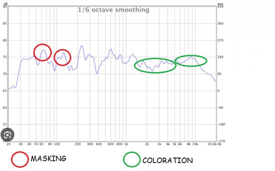

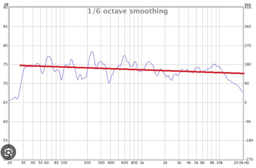

So why is an even FR so damn important? Two acoustic phenomenon plays a role. Let's look at an example of a FR measurement I found online.
In the bass and upper bass, we see a couple of peaks followed by dips. These tend to be room induced and being low in frequency the are predominantly a minimum phase issue, so we can to a certain extent smooth these out.
In terms of how our ears perceive this, we will hear 60-70 hz and 100-150 hz quite a bit louder than the surrounding frequencies due to masking. Play some music relatively loud and then have a person talking to you (or turn on the tv) and you won't hear what the person is saying, that is masking. MP3 codec is based on how our ear/brain masks lower sounds relative to high sound.
Higher up at 1500-5000 hz we have a broad dip (BBC dip) and then a rising response up to 10 KHz. This will be perceived as a tonal coloration.
At 400 hz we have a sharp dip, but our ears are quite insensitive to sharp dips and much more prone to high peaks, because of the masking effect.
Another way to determine if a frequency deviation is a potential problem, is to look at the total area the problem occupies. Again from the example we can draw a line and have a quick estimation of how big a problem a deviation will be. In this example the problems ain't so bad at all. But fixing the issues in the example will definitely give a very different tonal balance, which is very important if high fidelity is the goal. Of course it doesn't have to measure perfectly to sound good, but a very uneven response simply ruins the music completely.
